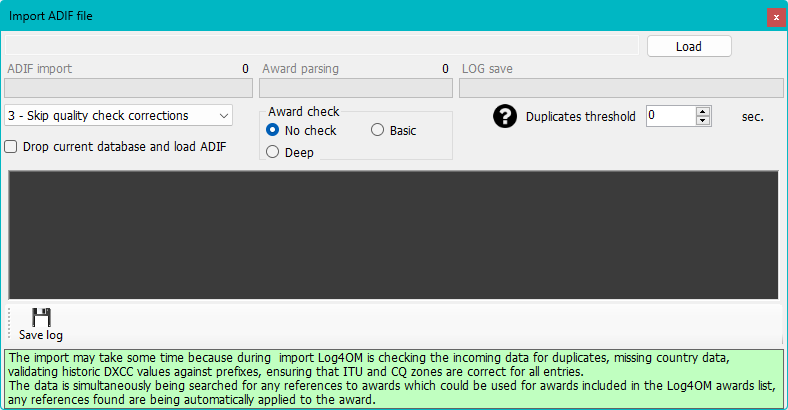

I did what you just wrote, but the first example I look for is 3D2CY : it was considered as Fiji, while it was actually Conway Reef. This is onoly one example out of many similar.
After running the maintenance, it was not changed, while I have the latest Clublog file.
At least I think so, because when I do update ressources/clublog, I do not see anything happening...
Same with "Maintenance/Rescan references", nothing seems to happen.
Another set of wrong country info is all the VP8s (South Georgia, Sandwich, Shetland and Orkney).No VP8 at all is considered as the right country.
For info, I imported all my QSOs from DX4Win, which has the correct country info for all QSOs,, as it does consider the AD1C file. Why is the country changed when I import into Log4OM ?
Thanks + 73
Paul F6EXV
Posts: 11591
Re: Country update
Changed because you selected update in adif import
If your happy with dxwin data then delete the imported files in log4om and import the dxwin adif again without updates selected
