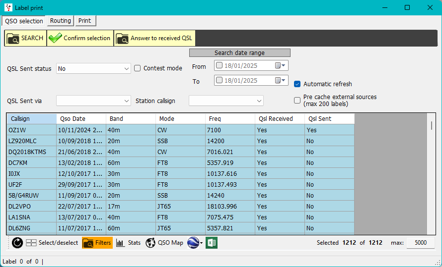

What is the QSL sent status for the 60 QSO's?
Whatever it is then select that in the label print window, like QSL sent status = No, Requested, queued etc
Click 'Search'
Refine the search using filters at bottom and/or select those to be processed
Alternatively use the filters in Label print as below to just select the QSO's that you have received cards for

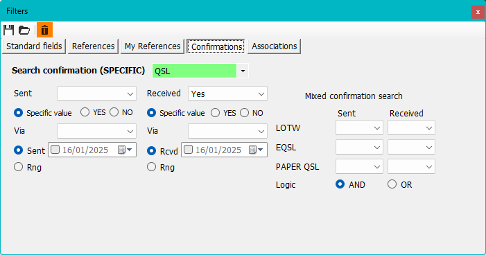

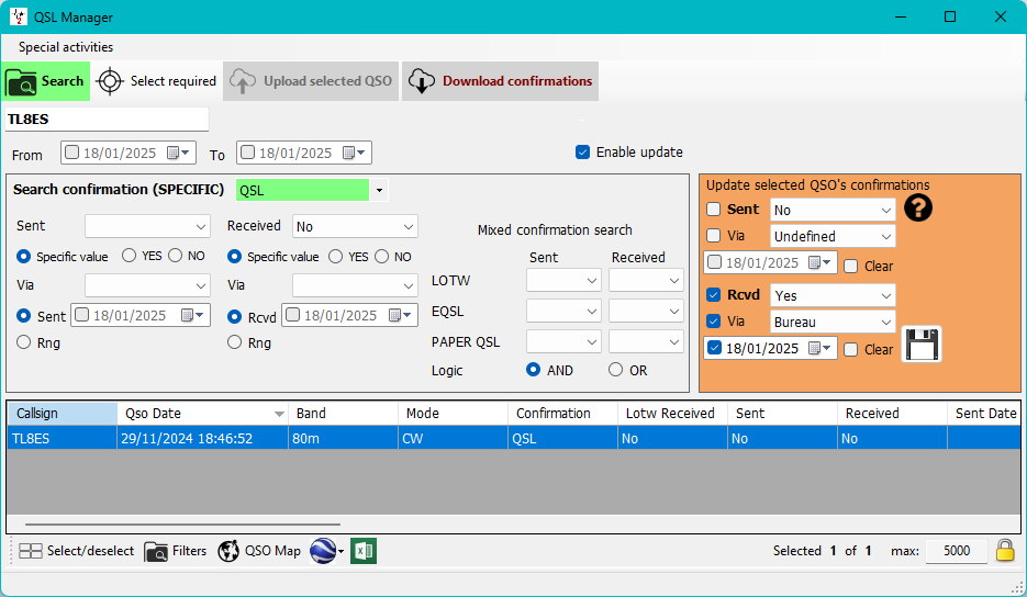

For any bulk search filter to work you must have something that is common to all of the items being searched for and you dont seem to have anything that is common to the 60 QSO's, for example............... Date or time frame, Country (DXCC), QSL received status = Yes, Contest name, membership or award groups like FISTS - Lighthouses - IOTA, satellite name or band.
Probably your best plan would be to mark those cards received
Then once the 60 QSO's are marked received, in the Label print interface filter on QSL Received status = Y
Select the 60 QSO's and proceed with the label print operation
See screen shots below for guidence
