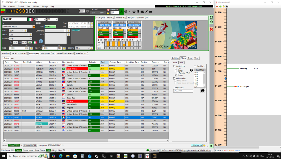

can you tell me why my band map does not display all the stations that are found by the cluster.....see my print screen...

band Map and Cluster are different value...
- band map.png (239.31 KiB) Viewed 658 times

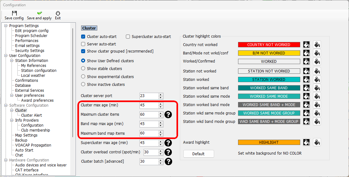

Check your cluster & band map settings at: Settings / Configuration / Cluster

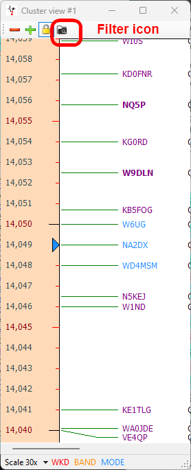

Also check your filter settings for the band map display(s). The filter settings affect 'each' appearance of such.
I happen to use the band map that is integrated into the Main UI as opposed to the one you can move about the screen wherever you need it to be. The filter for each band map only affects "that" band map.
Images below may help.
- cluster-settings.png (66.89 KiB) Viewed 649 times
- bandmap.png (18.38 KiB) Viewed 649 times

Thanks Nolan for your quick response
your explanations are very clear..i don't know why but my parameters were completely wrong...
