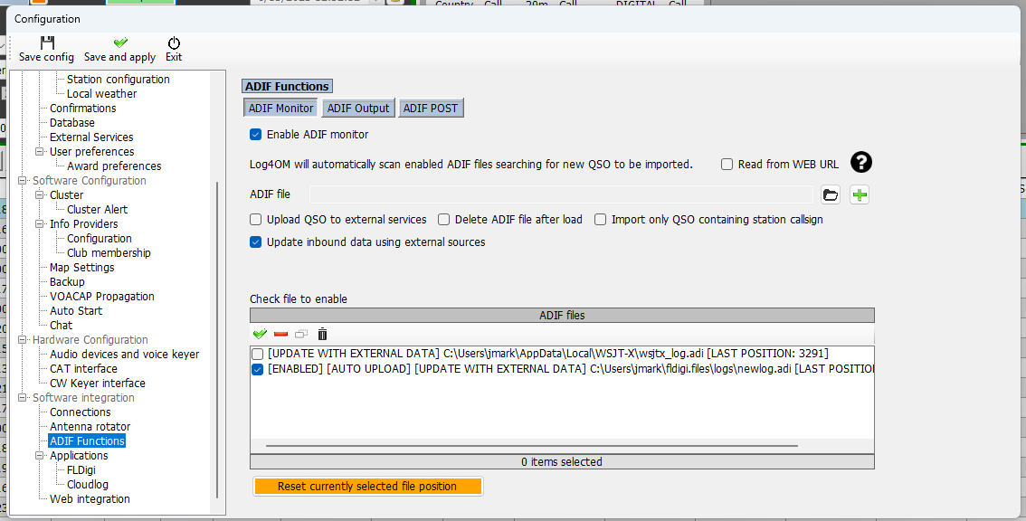

Yes, LOG4OM is monitoring the Fldigi ADIF file. Attached is the configuration for the ADIF function.

Read the text of the item you checked it says it will update from external data, like qrz,!

Looks like the problem is that the "Update inbound data using external source". Problem is that after I uncheck the box and save, when I return to the configuration page, the box is still checked. Cannot get the box to stay unchecked. is there a particular file under Program Files (x86)/IW3HMH/Log4OM NextGen/ that I can delete to get rid of the saved configuration? I really don't want to delete everything and start over.

Did you uncheck BOTH boxes and then click Save and Apply
I just tested and it works fine but you MUST uncheck both boxes
You could also delete that line of instructions
Should look like this, note the ADIF file path
