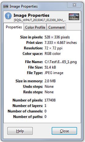

No, irfanvview is not reporting a "false positive". I just opened a saved eQSL from the log4OM QSL save directory ( ... log4OM - N5INP - 2015 /. It was stored as a .png file. I opened that eQSL in Gimp - another well known image editing program, and it reports the file is a .jpg encoded file (see attachment) - even if the extension is .png. It's not a .png file.
So no, there is no "false positive": the file is not a .png it's a .jpg.
I understand now you don't want to do anything about it, (such as change the extension to the correct one), and it's something coming from eQSL, but that does not mean it's not wrong. If eQSL is sending it out with the wrong extension, I understand that, but the file is in objective fact a .jpg with a .png extension, which is not correct.
