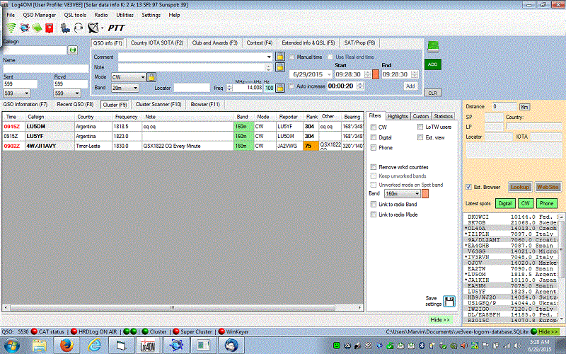

Here's a depiction of the odd behavior I've observed. I don't work 160m so I have none of the above entities confirmed on 160m but I do have them confirmed on all modes on other bands. The first picture highlights the MODE as unconfirmed, but the second picture doesn't.
I think this is related to the Unworked mode on spot band feature that has some bug in it. I posted a separate error report at viewtopic.php?f=7&t=1623
When Unworked mode on spot band is selected AND SAVED, upon restart of LOG4OM (or at least upon cluster refresh) the application will indeed highlight unworked (or unconfirmed) mode on spot band, but this will happen even after the subsequent disabling of this feature (view attached pictures). Disabling alone (without saving) of this feature will not prevent unworked (or unconfirmed) mode on spot band to be highlighted.
It works the same way the other way around. If users have their preferences saved with Unworked mode on spot band disabled, enabling alone (without saving) this feature will not enable unworked (or unconfirmed) mode on spot band to be highlighted. This feature, for some reason, requires to be saved and LOG4OM restarted or at least cluster needs to be refreshed.

Daniele, in my last post I was only trying to point out, as seen on the two pictures in my previous post, that the feature highlights MODE inconsistently. It may highlight MODE one time and it may not highlight it at other time. Notice, the same features are enabled, but the result is different.
I suspect this issue is related to the issue I posted about earlier this morning at viewtopic.php?f=7&t=1623 - I suspect as soon as that gets corrected, this issue will be corrected automatically, too.
I suspect I haven't been able yet to describe this issue in this thread in a way you guys would understand me :mrgreen: , but trust me, it's not working the way you guys meant it to work. :mrgreen:
73 Marvin VE3VEE
