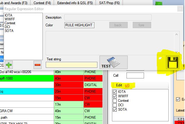

DF5WW wrote:I can confirm this issue .... No highlighted comments in the cluster window when a IOTA/SOTA e.g. is spotted. Have seen this problem yesterday when i worked a SOTA station and send a spot with the SOTA reference :( :(
This is caused by a change we made when adding the regular expressions to the Alert you can fix this by deleting the file highlighted in the image below and restarting Log4OM
File is located at C:\Users\YOUR USER NAME\AppData\Roaming\LogOM

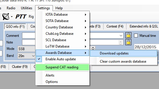

I think I have spotted another difference/problem. I think I noticed that now when I manually type in a station operating a WWFF - VKFF park that the option for VKFF doesn't show and nor does the KRNPA award but the SANCPA does. So to manually add an award for VKFF I now select WWFF and then scroll through all the WWFF until I come to the VKFF number I want which of course still works but differently to before. Double clicking an entry from the cluster automatically places the details exactly as they should be so its no biggy ...just (I think) different to before ..and no Keith Roget Memorial Parks Award.

Just to also confirm that the Rig Cluster XML file reappeared this morning. So I shut down, deleted the file and re-started and it was fine again.
You did resave the filters the first time you deleted the file, didn't you?

OK ..so if I put in VK5PAS or VK3HRA or any VK ...in fact just typing VK5 or VK3 will work. Then I click the Awards and normally VKFF would be visible along with Keith Roget but now just WWFF, so click that and scroll through all the countries until I reach VKFF. Sometime I do it this way and sometimes I use the search if they have given me the
This is caused by the latest file from WWFF not having all of the DXCC references in it - We will fix this
Please update the awards manually to fix this issue

Thanks for the great support ...yes the update fixed the problem.
The award would be known as KRMNPA (Keith Roget Memorial National Park Award - Victorian version of the South Australian award but somewhat older) and I was sure it also came up under the awards along with the SANPCPA award but maybe I was mistaken now....Anyway its not an issue as the parks now come up as they should.
