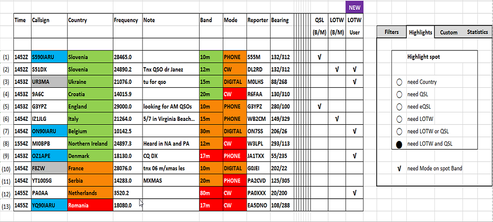

Graphical description pleasepa2kw wrote:"I thought that the combination of the LOTW Users selection in the 'Filters' tab when used in conjunction with the selection of 'by LOTW or QSL NOT received' in the 'Highlights' tab fulfilled this purpose?"
No, I'm not looking for spots in cluster window limited to LOTW users only, but spots that went through the filters which are LOTW users highlighted/marked.
73's Evert PA2KW
Cluster Filters
- Posts: 11582
Re: Cluster Filters
Re: Cluster Filters

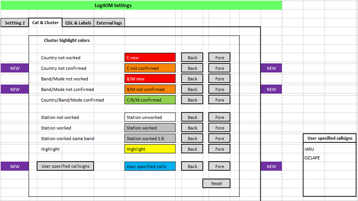

I did some grahpical work during Xmas to make my feature requests for the cluster window visible.
I also proposed some changes in description (e.a. to avoid double denials in one description as they are mostly felt as brain crackers)
in Log4OM settings / TAB [Cat & Cluster]
- Added "Country not confirmed"
- Added "Band/Mode not confirmed"
- Added "User specified callsigns" (This was on the list already if I understood it correctly)
I just used the colors Red (Alarm), Orange (Alert) and Green (Ok) but they are configurable as they are now allready.
in Cluster window (Extended View]
- Added collum "LOTW User"
Cat & Cluster Cluster window examples gives all (I think) possible combinations available for the specific setting of the "highlight spot".
(I hope I didn't make a mistake in the last 2 examples)
I think this will help the DXCC/Slot hunter who likes both QSL and LOTW confirmation.
At least he will be warned/alerted if applicable.
73's, Evert PA2KW

- Posts: 11582
Re: Cluster Filters
Evert,
I will add this to the Mantis list
A couple of points
I like the title 'Need LOTW' etc
Perhaps we could also remove the / in the options and change it to
'Band or mode not worked'
'Band or mode not confirmed'
'Country, Band or Mode Confirmed'
I believe these changes make it more understandable?
A couple of points

Re: Cluster Filters
On the same theme, a facility to highlight LOTW users (as opposed to the current tick box that only shows LOTW cluster stations) would be useful and should be fairly easy.
73 Dave
73 Dave
