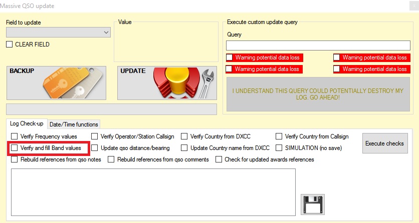

bbones wrote: I'm currently updating the Band and Freq fields as the imported ADIF file from G8PUT had no data in the Band field and I have missed some of the frequencies out.
You can do that automatically in the QSO Manager - See the YouTube video on archive manager and bulk editing
If you have any WAB references in your comments or notes fields you can update your award references automatically here also - See the boxes marked 'Rebuild references from QSO notes' and 'Rebuild references from QSO comments'

I have already made a start and the latest info will speed things up. I have over 3000 QSO's to be checked and edited but it will be worth it to get the best out of the logger.

Video?, I did not know there was a video. Thanks Terry, It really cleared things up for me. Especially useful is the sort and then bulk update.
