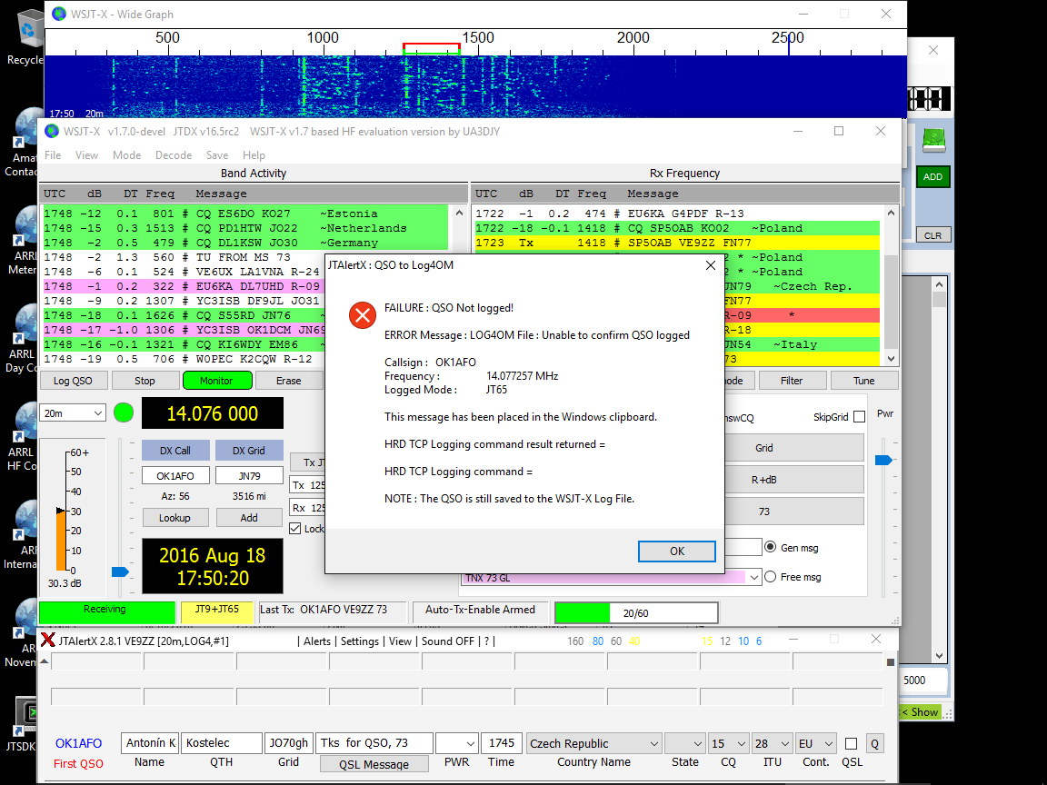

Hi everyone. I'm new to Log4OM and would like to use it to log QSO's from JTAlert. I'm abandoning HRD and looking for another logging program to use. When I try to log a contact I get an error. Attached is a screen capture of the error. It refers to HRD but I cleaned HRD completely from my PC, I even did a regedit to clean it further. Anyway I hope someone can help me out. I followed all the directions in the manual for locating the log file but still get the error. I'm using 1.25 portable.
Thanks in advance de VE9ZZ
logging error.png (151.56 KiB) Viewed 11099 times
Posts: 11571
Re: JT Alert integration.
I believe that although JT Alert is flagging an error that you will find that Log4OM has actually logged the QSO, have you checked?
VE9ZZ
Posts: 4
Joined: 17 Aug 2016, 20:44
Post by VE9ZZ »
Thanks Terry , yes I checked and it doesn't log the contact.

Posts: 11571
VE9ZZ wrote:Thanks Terry , yes I checked and it doesn't log the contact.
de VE9ZZ
Are you certain that the JTAlert configuration is set up correctly for Log4OM?
Perhaps someone that uses JTAlert could advise you
VE9ZZ
Posts: 4
Post by VE9ZZ »
Been over it more than a dozen times, my head is starting to hurt. I'll log the contacts manually for now and hope someday I'll find the solution.
