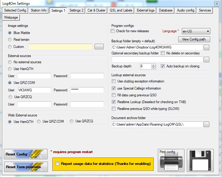

Hi everyone. I have also had the grid locator issue. A while back I got an email from HRDLog with a list of locators that had been changed by LOTW. Only a small list ... 197 QSO's. So I had to go through and check each one manually. I will add a screen shot of my Log4OM Settings 1 page below. The other thing I noticed is that the software only uses/plots grids down to the four numerals not six ie: QF22. Now for the new ARRL Grid chase I am pretty sure that it requires 6. Is there a way to force Log4OM to use the six numeral of the Grid Square?

Thanks for the reply. Also I spoke to a mate who also uses Log40M and we went through my settings. Changed a few things in Settings 1 and re confirmed my QRZ password. All fixed now. I think I borked my password.

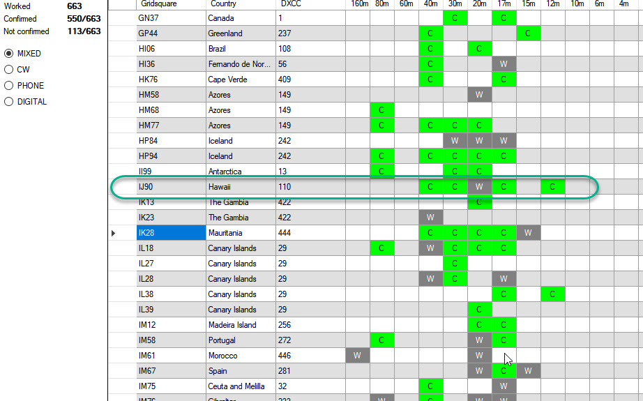

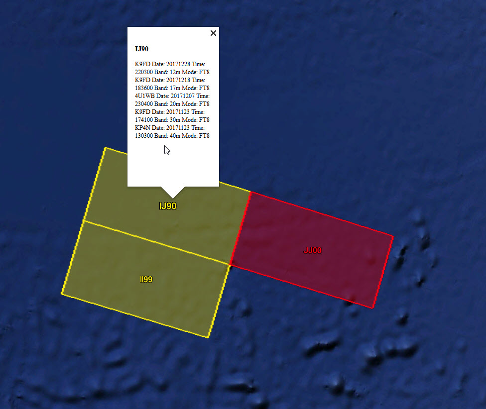

Just noticed in WSJT-X the grid is logged as "0" on the Hawaii station on some and correctly on the others.
The ones with "0" for grid square are logged in Log4OM as grid IJ90FF
<call:4>K9FD <gridsquare:0> <mode:3>FT8 <rst_sent:3>-02 <rst_rcvd:3>+00 <qso_date:8>20171218 <time_on:6>183645 <qso_date_off:8>20171218 <time_off:6>183745 <band:3>17m <freq:9>18.100956 <station_callsign:5>KD0ZV <my_gridsquare:6>EN31eq <eor>
Just noticed that IJ90 which I think is off the coast of Africa is listing as Hawaii in my Log4OM awards.
Re: Grid locator query
Off the coast of Africa
- Posts: 11582
When no locator is available from either the on-line lookup service, probably because the call sign owner did not provide the information, or a QSO received from an external source that does not contain the grid reference then Log4OM will use the 'centre of the world' locator which is just off the coast of Africa in the Atlantic.
