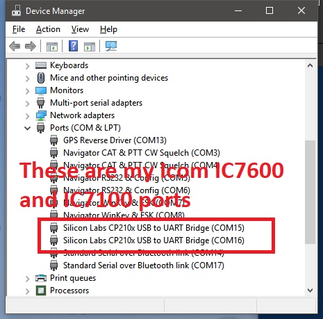

Don't forget the port number will be different using the 7300 USB connection to the one that the Digikeyer uses
Take a look at the device manager and watch while you disconnect the USB lead and re-connect it this will identify the correct port numbers

- Posts: 11609
Re: Transmit always on IC-7300

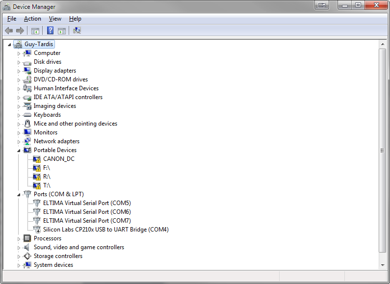

Please post a screen shot of the device manager showing the ports in a similar graphic to the one I postedG4DWV - Guy wrote: 20 Oct 2017, 17:54
I am connected to the correct com port. In my case it is com port 5 with DigiKeyerII. When I did the test, I connected to com port 4.
Attached is my screenshot.
Com port 4 is disabled on the advice of microHAM tech support. That is the one inside the 7300. The other three are related to the DigiKeyer II. Port 5 is used for CAT control.
