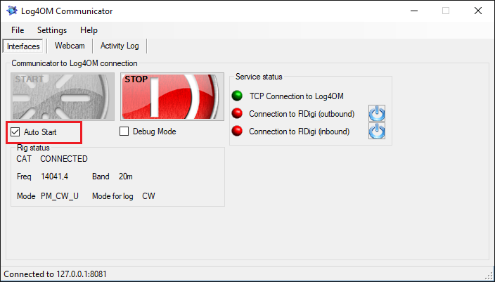

Have you set the communicator to Autostart on your /A Equipement ?
If not you can try to start WCF manually via the button in the main window:

Re: JTalert: QSO to Log4OM (mySQL)
I don´t know why the WCF services are not running but if you take a look to my last post
there is a second picture. In the red marked Box you see a little "Down" arrow. There you
can open a small pulldown menu where you can start WCF manually.
On my end i only have a stopped WCF Service if i have open a second instance of Log4OM.
If i start the Log4OM for DL0AK first i have WCF on there but if i start the DF5WW Log as
a second instance in this one i don´t have WCF on.
