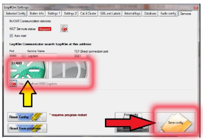

3. The attached graphic image of the Services screen (taken from the current operating manual) does not show the screen currently used in LOG4OM. The SAVE icon is now a floppy disc and the GREEN START is in another position. Fact #2, screen shots need to be 100% accurate, or don’t include them.

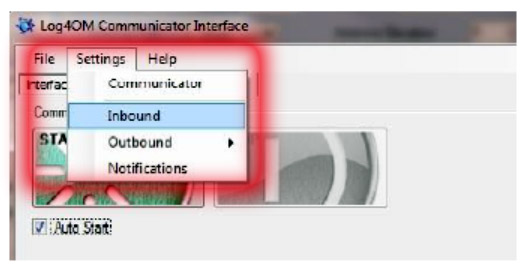

4. Where or how does one click to get the Inbound / Outbound drop-down menu to appear?

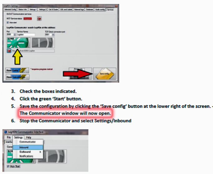

5. On Pg 183 of the current manual, Step #3 states, “Check the boxes indicated”. What boxes? There aren’t any boxes to “check”. “Save and Start will cause the communicator window to open” – Huh, it’s already open?
I will update the manual when time permits
Communicator - Settings/inbound/inbound settings
This refers to the 'Auto start' box at the top, I will change the graphic

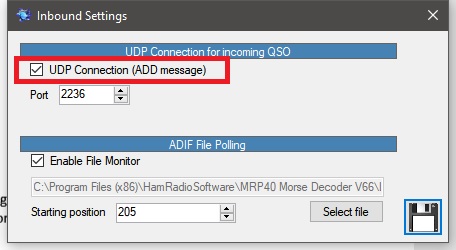

6. “Inbound messages by UDP” – “Check the UDP (Add message) Check Box – I have no idea what this is saying – add what message?
It means what it says check the box in the inbound settings window that has the title "UDP Connection (Add message)" see below

I wanted to share some info that you and LOG4OM users might find helpful. On Pg 183, Step 5, it states that after clicking on “Save Config” the “the Communicator window will now open”. I’ve tried two different PC’s running Windows 10 (build 1803). The Communicator window starts, but it immediately minimizes itself to the task bar. You never really see it. It was the similarity of the Services window and the Communicator window that was driving me crazy – not being able to locate the “Inbound” tab.
Once you discover that, and you click on the minimized tab, everything starts agreeing with the manual.
