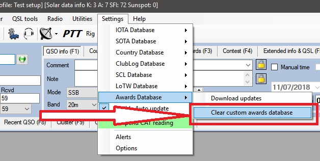

Did you try deleting the awards in the log4om menu and then downloading/updating the awards followed by a restart of log4om?
From your latest post I can now understand that you don't have a complete awards list of references for RDA probably a bad download or install.
Try the above first and if that does not work I will provide a file for you to import in the awards manager

Excuse my lack of knowledge and if you don´'t mind me asking, but can you describe a bit more clearly where I delete and download the files?
Delete: Utilities / Awards Manager / RDA Award
Download: Settings / Awards Database / Download Updates
makes no difference.
