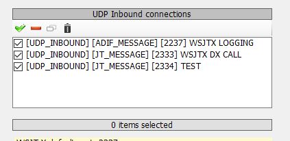

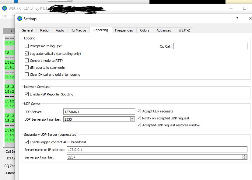

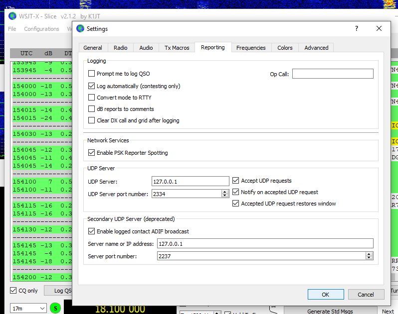

I have it set that way Terry
WSJT-X is on port 2334
Bot is on port 2333
Log4OM is set to listen to both,
I'm trying to find error's in the log file but it's not making any sense to me
Bot is on port 2333
