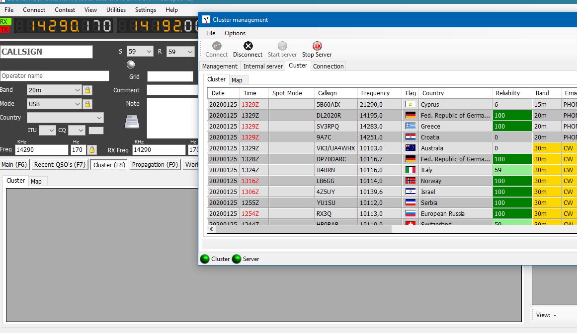

This seems to be a hit and miss issue of not showing cluster information on the cluster tab. It connects to a server and show cluster info but does not replicate to the right spots. Very frustrating. No filters selected etc.

Re-installing did not fix this for me. Still no spots showing on the map or the cluster screens (F8). I am connected to 2 clusters, I see I get logged in and spots get downloaded. I did notice if I open the band map using the icon at the top of the main UI spots show there. Strange....
Any suggestions???? I'm at a lose with this one.

Max, thanks for that reminder. After a couple hours with Doug on the phone and temviewer, no joy. Still no spots showing in any of the cluster windows (except for the Cluster Manager where it shows the login info). After I hung with Doug (thanks again Doug for all your time) I was away from the computer for a few hours doing other things. When I came back there was spots populating the cluster windows (F8 tab and the external cluster window). What happened when I was away from the computer I have no idea. Feeling frisky I closed and opened Log4 a few times and all cluster functionality continued to work. Software healing itself.... :twisted:
