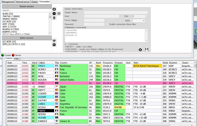

Added the secondary server, and the frozen spots returned. Im watching them slowly peel away as the "Time" reaches the actual time. Frozen spots are those at the top above the pink highlight. Updated spots are below. The frozen ones at the top are the ones I'm used to seeing. I believe they are from 2 days ago. Everytime its the same one at the top. How do I add an attachment?

Set the cluster age to 10 min, and the frozen ones disappeared. Running smoothly now.
