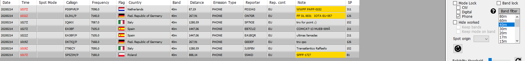

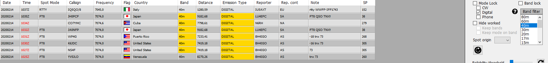

Thanks for the suggestions surrounding FT8. I have, as an experiment, played with adapting bandplan_r.xml.
I only did 40m for now. Using the settings below it appears the cluster view is showing me what I prefer (tastes differ, obviously :mrgreen: )
