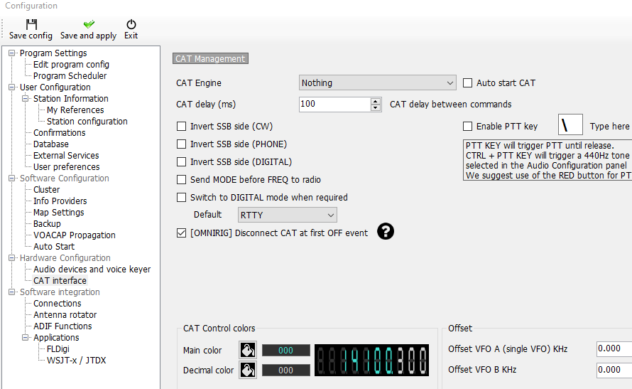

I don't have CAT ( my TX is not connected to the computer) old TS140S
but I use the V1 version = everyone can see me ON AIR and the frequency on HRDLOG web page
but if I use the V2 version = HRDLOG web page show 'NOT on air'
what is wrong

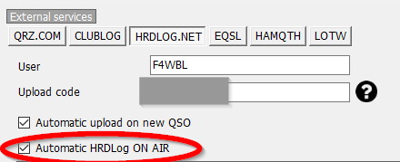

here my config
HRDLog On AIR status

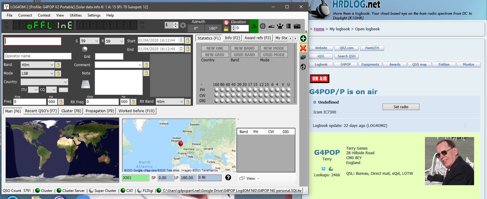

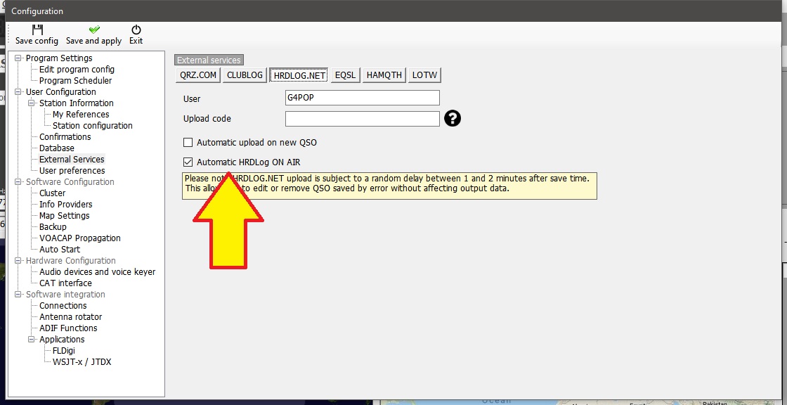

Re: HRDLog On AIR status
This is where you set the on air control and your HRDLog special code etc
of course I did
here the pic
here the pic
- Posts: 11582
I have checked several times and it is working for me
Might be a good idea to request a new code from Claudio

- Posts: 11582
As you can see my radio is turned of and not connected its Off Line

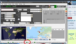

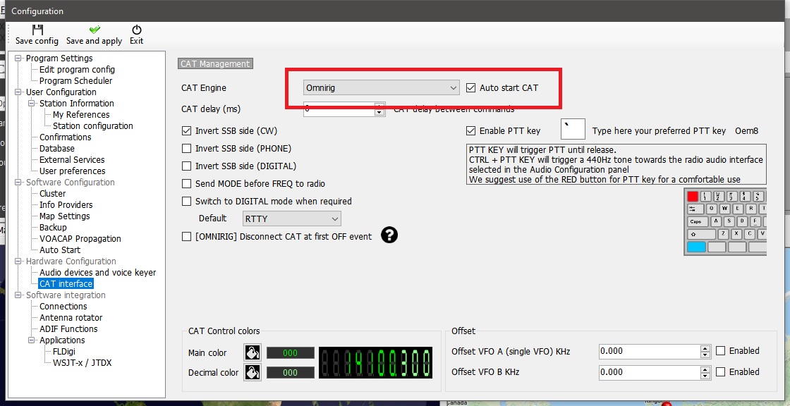

Hello terry
Sorry to bugg you again, but I am really lost !
ok you TX not connected to a PC
but how CAT in ON (green color) at the bottom of your screen!
May I contact you by email (then teamviewer or whatsapp) so I can understand your config vs mine..

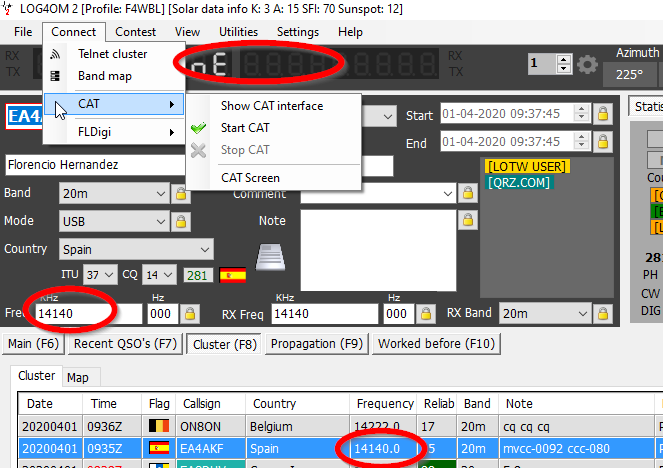

Hello Everyone
I have been in contact with Daniele (IW3HMH0 regarding this point (thank you Daniele for your time)
Unfortunately Log4OM V2 will work with HRDLOG.net (for the On Air and frequency status) ONLY if you have a TX connected via CAT to LOG4OM V2.
This was working with Log4OM V1 (without a Radio connected)
but not on V2 version .
This change was asked by Claudio IW1QLH, admin of HRDLOG.NET, as he wants only “real” online data to actual “real” frequencies.
Personnaly I am quite sorry of this decision. I don't have a HF radio with data communication (I use an OLD TS140S)
so it is too bad for a lot of us with old radio without this possibilty.
