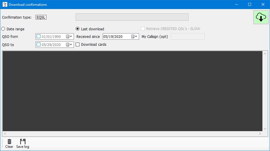

WS2K wrote: 29 May 2020, 14:12 Hi and thanks for the quick reply! I am running the latest version, 2.6.1.0. Do I need to delete some .ini file so that this version can overwrite with a fresh start?
Thanks again!

I also went to QSL Manager to do downloads from Eqsl and captured screen clips of my first download (with last download date noted) and then I restarted V2 and did the same routine and captured yet another clip with the refreshed download date. I've attached the clips below. Neither of them reverted to a 2019 date.
If you are still experiencing this can you capture some screen clips and add on this thread with any other additional information?

As I was doing more testing on this eQSL download issue today ... I did yet another eQSL d/l ... I DID get a shift in the received since date to "one year ago" from today.
So it relates to doing multiple visits to eQSL for d/l's and causes the Received Since date to shift one year.
Only doing one visit to the eQSL site for d/l's per day does not appear to cause the same hiccup.
I'll refresh my note to the Alpha Team.

It´s only eQSL download date that steps back when you download more than 1 time a day.

Thanks for the followup. My experience is the same as DF5WW, it's only on eQSL if there is more than one download/day. Then it drops back one year. The first download is normal.

This has been corrected in a pending release. We've been testing for a bit now to confirm.

Thank you! I downloaded the new version this morning, and it seems to work correctly now. The calendar does not go back one year on a second and subsequent requests.
