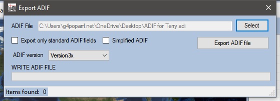

Flag also "Export only adif fields" and " Simplified adif"?
73s, Camillo
Posts: 11608
Re: Lost all settings!
iz6gvc wrote: 24 May 2020, 11:05 Flag also "Export only adif fields" and " Simplified adif"?
No ignore those check boxes otherwise all Log4OM dedicated information will NOT be included
Just like this
