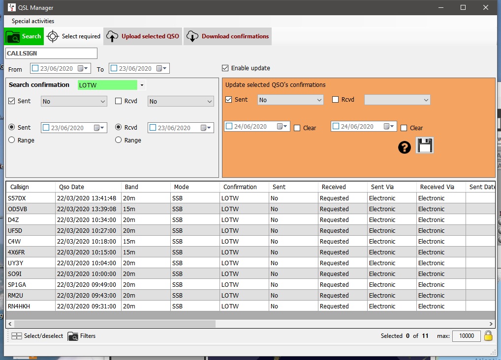

The left side.
Click the left side pulldown to a non-default and click the "Sent" box. Then click "Select required" -- the box turns back to the default so the pulldown is useless.

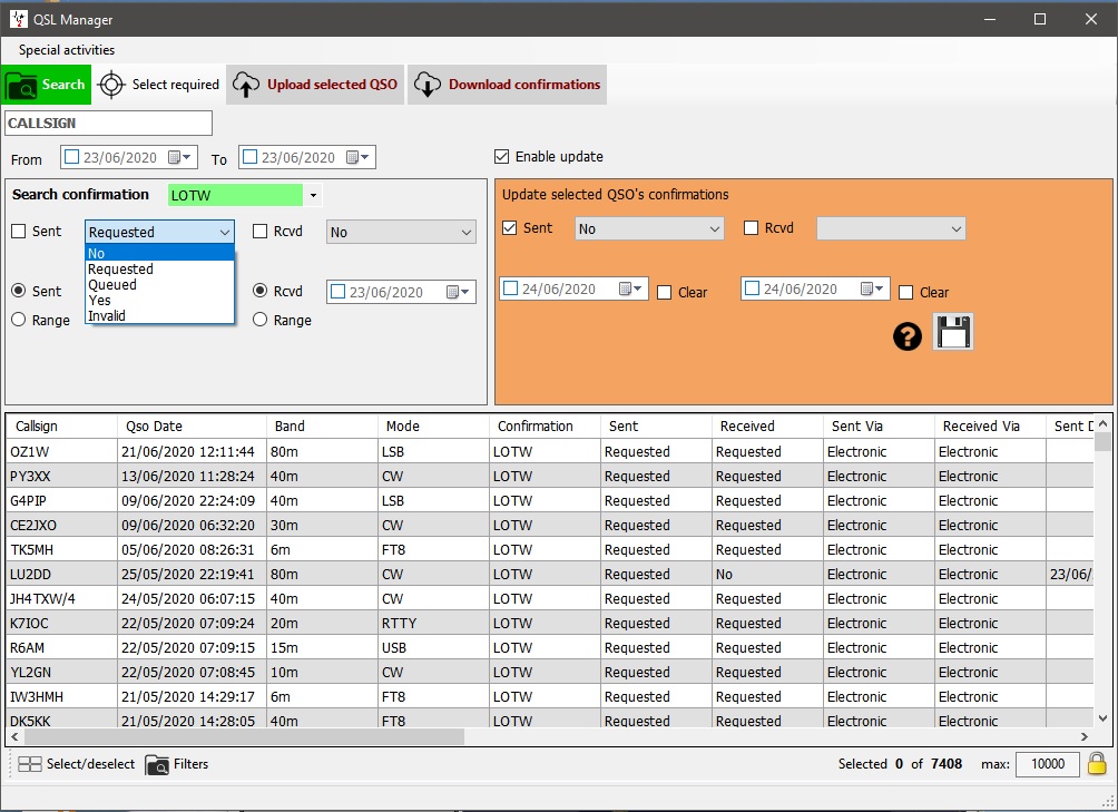

As you can see I am able to select from the left hand drop down menu also, the first image is at the point of menu selection and the second image is after having clicked on 'Select required' all is functioning as designed!
Incidentally if you check the box 'Sent' you would get the same result if you clicked on 'Search' - 'Select required' just sets the search filter in accordance with the choice made in the 'External services' menu below
That of course depends on the selection made in external services (See below) as explained in the user guide and YouTube tutorials!

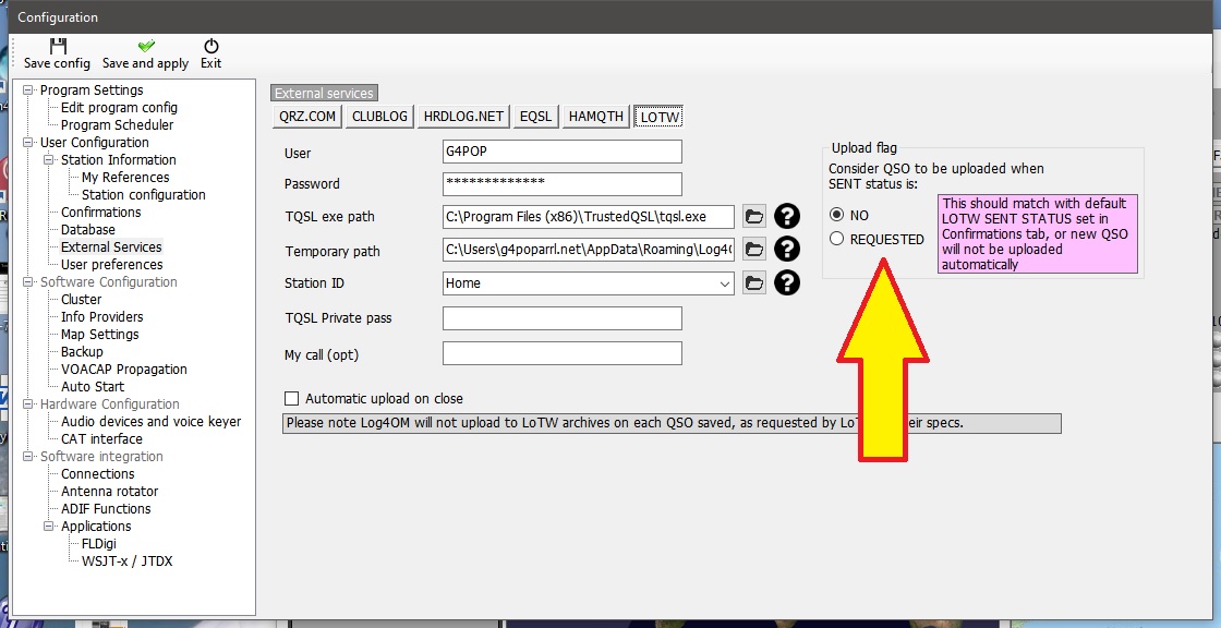

Clearly you still dont have the setting in the Program Config/External services/LOTW set correctly as in my screen shot in my last postw9mdb wrote: 24 Jun 2020, 03:30 Oops...let me correct that...still broken...

Mike your still missing the point
Either
Use the pull down menu to select the search criteria required and then click search to filter on the selected criteria
Or
Clicking search required automatically selects the required status selected in the program config and completes the search based on that selection.
Quiet simply it's two options both of which are demonstrated in the wo YouTube tutorials about confirmations.
