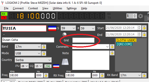

Sorry I tried a screen shot earlier but it said file too big. Here's a cropped one red circle.
- grid.png (27.26 KiB) Viewed 3490 times
Thanks Steve M0ZEH

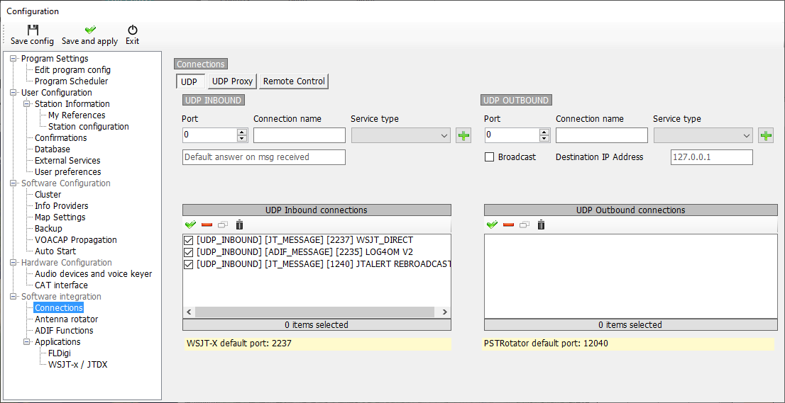

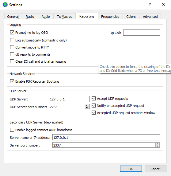

I redid all the settings again as per the manual.
- wsjt-x settings.png (28.21 KiB) Viewed 3490 times
- log4om settings.png (54.8 KiB) Viewed 3490 times
Thanks Steve M0ZEH

OK so now we are getting to the point you were not refering to a display grid in JTAlert or WSJT or a grid in Log4OM like recent QSO's or Cluster your were refering to the Log4OM display of the other stations Grid locator (Maidenhead square)

2. Did you enable remote control port 2241 in Log4OM/Program config/Connections/remote control tab as in step one on page 164 of our user guide
3. Did you set up both the ADIF Inbound and JT Message JTAlert broadcast UDP ports exactly as in step 2 and 3 on page 165 of our user guide
4. Did you set WSJTUDP server port to 2333 and check the boxes as shown in step 4 on page 165/166 of our user guide

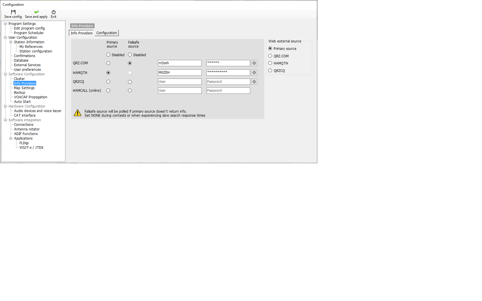

The answer was no so I swapped the info providers as pic below. I also unticked WSJT_DIRECT in connections.G4POP wrote: 21 Jun 2020, 12:43
Question
1. If you enter that call sign directly into Log4OM without JTAlert and WSJT running it the Grid reference found?
It Works now!!

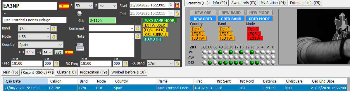

The only quirck I see shows in the picture below. You can see the recent qso shows FT8 where as the current mode shows usb. I'm not worried about that as long as the logged contact is correct. Maybe you can add this to the list of things to fix longterm.
Thanks again for all your help.
Steve M0ZEH

No the USB is there because that part of the bandplan is usb but what you see is just a lookup so the mode is incidental because as you found the QSO is logged with the correct mode.

As I said before the mode is FT8 initially but changes to usb a second later.
