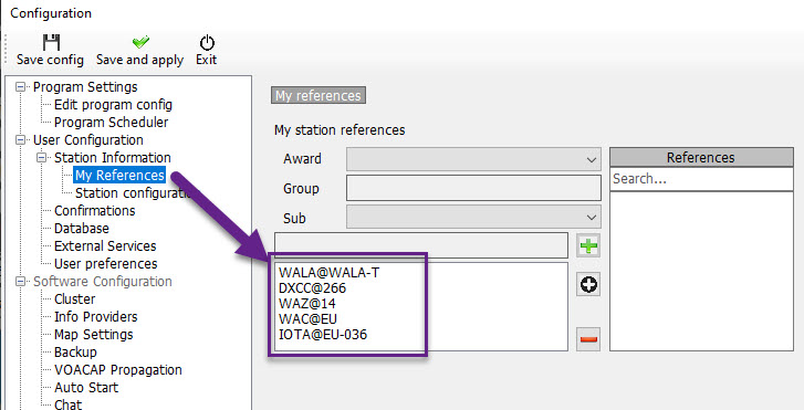

It's a strange behaviour, as the "qso" references, the references that are related to the QSO characteristics (continent, dxcc, state, waz, itu, etc) are not saved into MY REFERENCES, but it seems that this happens on some of them, according to your results.
Only "callsign" related (eg. an award that require to contact all callsign ending in XXX) or pure references should be printed there (and saved in the QSO under the MY REFERENCES area)
I'm adding a late chance block filter on print while investigating the issue.
In the meanwhile for the QSO with the issues you can manually remove unuseful references (that can be retrieved from the QSL itself) from qso.

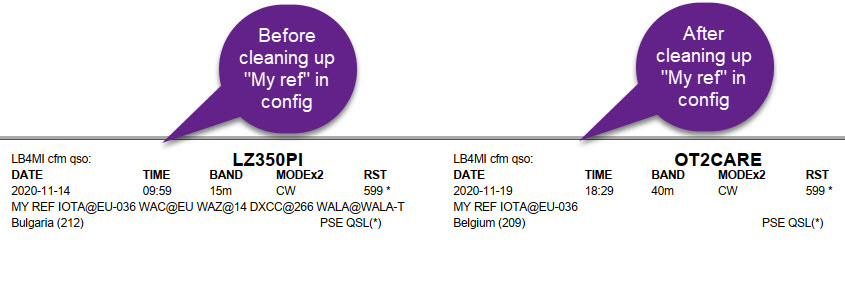

Re: "Label definition" -> Adjust QSL message
SOLVED
Your last post made me think... didn't I instert "My references" in to the config once? And yes...
So I cleaned that up, ran a new QSO to test, and compared with my previous QSO...
Ok; so understanding now how Log4OM looks for references, and the QSL label system pick them up, this became quite obvious
Thanks for assistance, and sorry for the extra work on that issue...

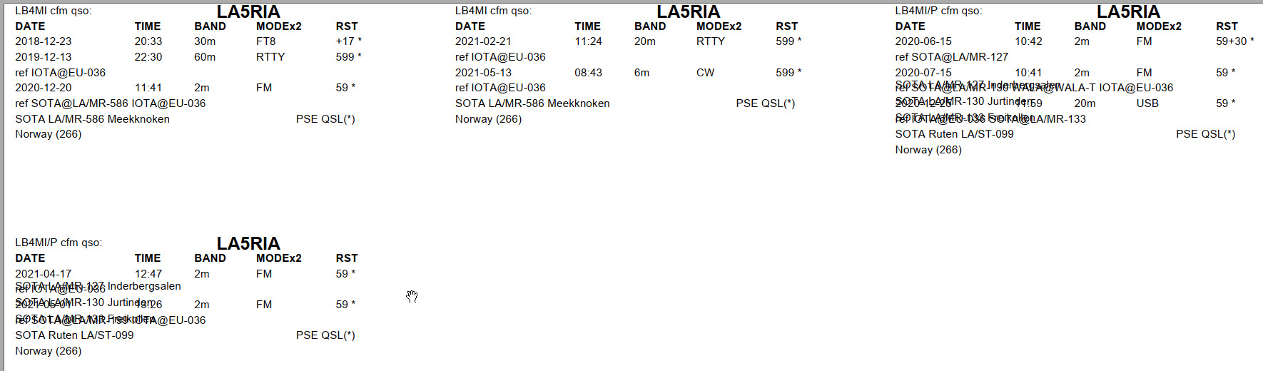

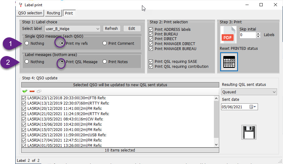

Hi again,
it seem that I get some issues with the labels, ref. V2.13.00
It's the "Labels messages (bottom area)" and then the field of "Print QSL message".
If you have e.g. three QSO's were each has a QSL message, they will be printed as shown here.
I guess the best solution is that the QSL message are printed underneath the QSO. As the "bottom area" only works if you have one line of text. And that again mean that you have to make 1 label pr. QSO, if you want the QSL message to be printed...?
