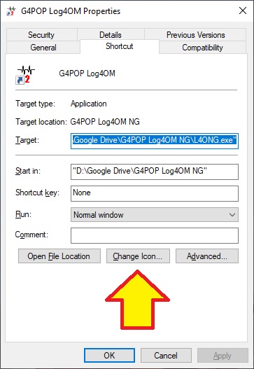

Changing the icon is a Windows function!
1. Right click on the desktop shortcut
2. Select properties
3. Click Change Icon
