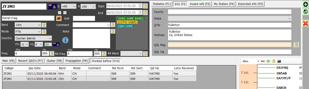

In the F7 window, there is a field called QSL via
In the F2 window, there is a field called QSL via
The content is different, while it is supposed to show the QSL manager. The qrz.com info is irrelevant... Showing something like "direct, bureau, LoTW" (retrieved from qrz.com)does not say which way I will send the card , if I do send one.
Regardless of the way I send a card, the manager is the usefull info.
But I will not insist, as when I mentioned list of QSL info are available, I am just sorry they cannot be imported.

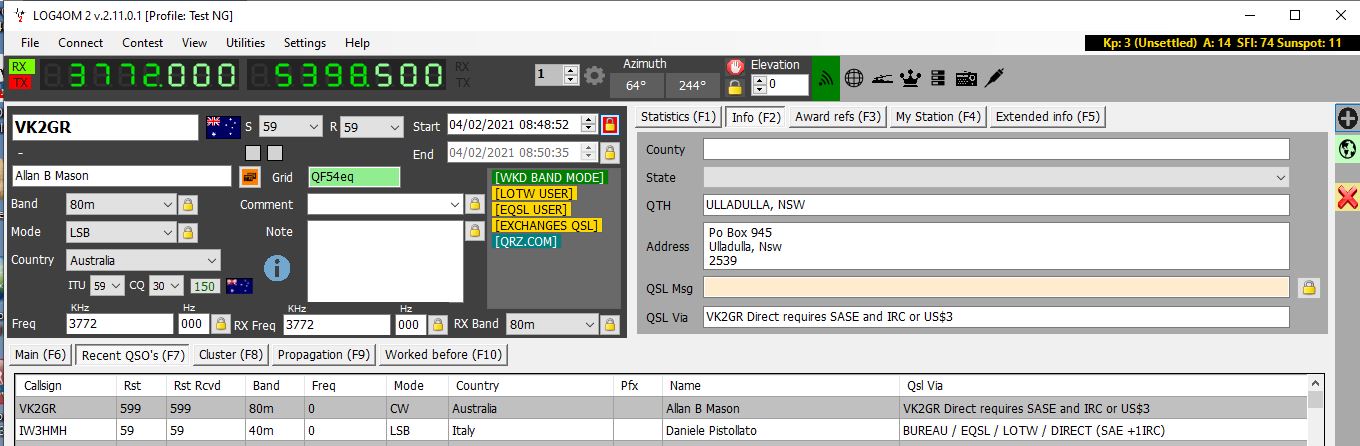

Here what I see here...
- QSLVIA.jpg (91.32 KiB) Viewed 2757 times

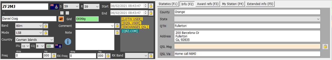

No Your refering to the WB4 window and of course it can be different because the other persons QSL via details may change over time or he might stop confirming altogether.
e.g. Years ago I was at a different QTH which was very sought after so I employed a QSL manager, now I am retired and have moved home I no longer use a manager and my QRZ lookup reflects that. Any QSO's made for my old QTH would be confirmed by the manager and the OLD record would display that, whereas now I dont use a manager so any new QSO's will not display the same QSL via details.
What is displayed in the historic data either in WB4 or recent QSO's is what was recorded at that time, not what is true today
The LIVE lookup done when you insert a call sign collects the information from the on line lookup source you choose - NOT from an old QSO and inserts that information in the F2 field
Your example lookup is blank in F2, probably because your using QRZ and because your only a 'Ham Member' who does not pay for the QRZ XML lookup service so the QRZ download API does not include the full data.
This is the result of a lookup of the same call as in your screen shot but it shows a lot more detail because I am a paid XML member of QRZ not a free Ham Member - You will note the QSL Via information is now different to your old record because the other person has changed it - Your lookup does not even show a grid square or the state and full address! because your not an XML subscriber
