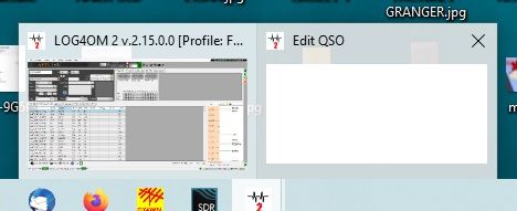

Here it is
Whether I try to edit from the "recent QSO" window, or the "worked before", it is the same : blank edit window, only on task bar...

You say windows 10 is that on a PC or are you running on a Mac under parallels or a Linux wine set up?F6EXV wrote: 24 Jul 2021, 08:35 Here it is
