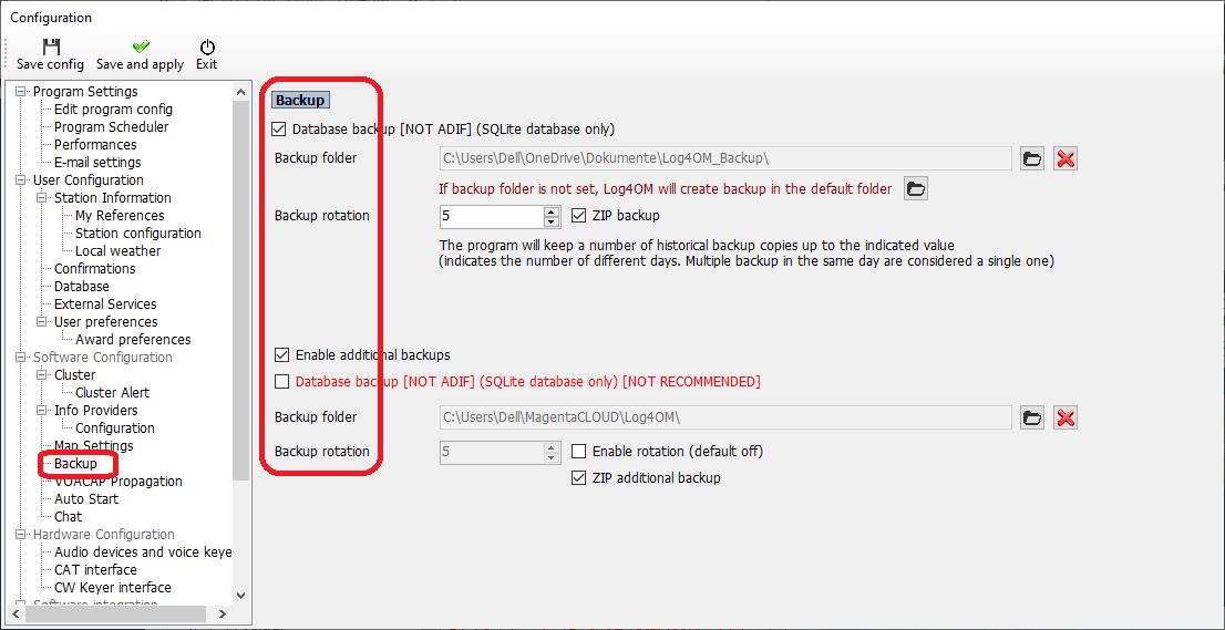

Use the ADIF import option of Log4OM to load it into the new databese you have created. There is no option to convert ist so import ADIF
is the way. Check in Log4OM settings that MySQL Database will be backed up next time into a ZIP file ....
