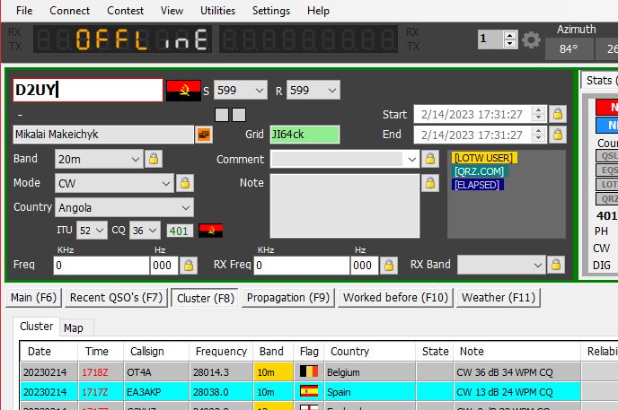

Re: Grid Square logging
Here's a screen shot I just took. I will see if upgrading to newer version changes it. He is, of course, identifying his square as JI64.

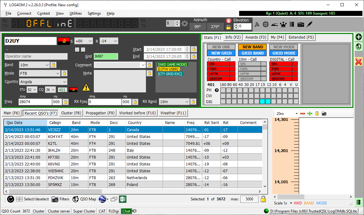

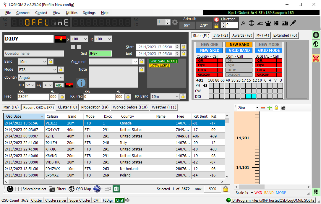

And after installing the beta, same thing:
Obviously this is unacceptable for FT8/4 operation and if this can't be rectified, I will have to find a new logging program, which would not make me happy.
Fred,
Try flipping CTY and Clublog Priorities. See my arrangement below.
I've also looked up D2UY and get a different grid that you have noted. This is just a manual entry of the OM's call into the Main UI.
Does flipping it simply use a different external database (CTY) rather than Clublog? I am not being picky about the data source used to give D2UY his square; I want WHATEVER square is in the JTDX log to be the one in Log4OM, even if it's out in the middle of the ocean (like he's /MM or something, or simply on vacation not at his listed grid square).
Fred,k1io wrote: 14 Feb 2023, 17:45 Does flipping it simply use a different external database (CTY) rather than Clublog? I am not being picky about the data source used to give D2UY his square; I want WHATEVER square is in the JTDX log to be the one in Log4OM, even if it's out in the middle of the ocean (like he's /MM or something, or simply on vacation not at his listed grid square).
Just flip to the order I have in my JPG and give it a try.
Why you can't try the suggestions we have given and/or looked in the User Guide for additional explanation is now getting beyond my understanding.
