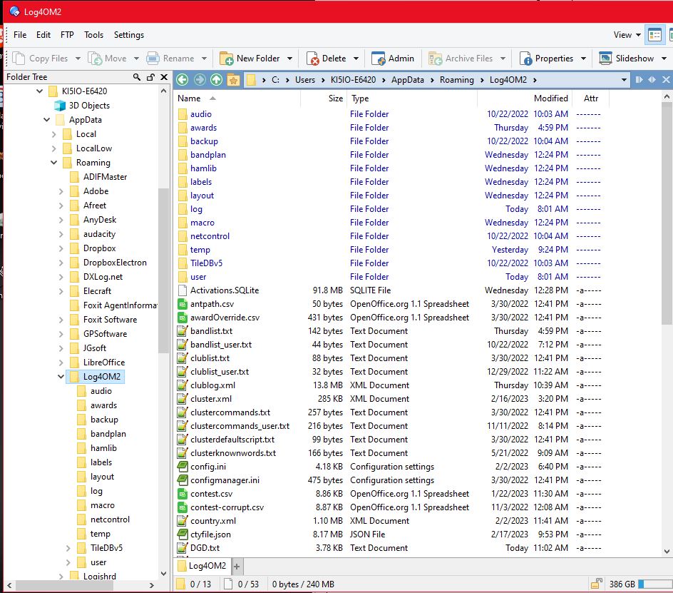

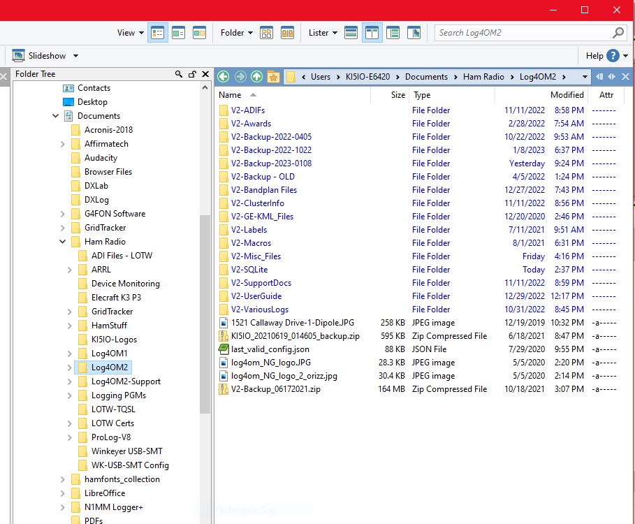

I've added two images below. One shows the many folders I created for Log4OM2 under "Documents" and the other shows the default arrangement of folders when the main (not 'portable') version of Log4OM2 is installed.
