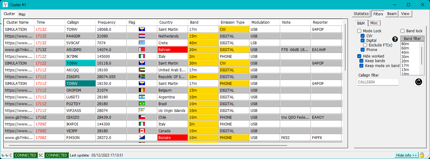

Rick,
I have just set up a dummy log entry the same as your 17m FT8 contact with TO9W and then did a spot simulation for 17m CW for TO9W and its working for me OK, see below, top row.
I think in the circumstances we have, where I cant replicate your issue, that you should send a support request to Lele at lele (AT) pisto.it so that he can track whats happening with your set up.

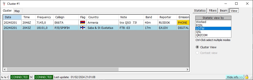

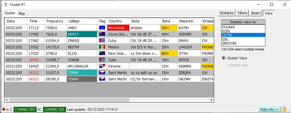

the key is in the VIEW tab.
You may have different ways to define "WORKED".
In my case, worked is "contacted at least one time in my life". No matter of confirmations received
In your case worked is "contacted AND have received an E-QSL"
In Terry case could be "contacted AND have received at least ONE LOTW or paper QSL"
This "contacted" behaviour is applied in all cluster views, and you can choose it independently on each single cluster by playing with the "VIEW" tab in the cluster parameters
So if you consider "worked" the "worked and logged" this qso will not be in your list as "not worked" forever, but if you consider "worked and have LOTW confirmation" the country/band/mode/call will remain "unworked" until you have the first LOTW confirmation on that country or country+band or country+mode or whatever you want as combo

OK it was a user error (my error...) and it was not too much complicated to fix it indeed but without your support I would be lost hi.
Using Dxcluster->View->Lotw on, I found a program configuration that match my need, great !
Now I'm also undestanding the colors which are very useful (maybe ?/help button in the cluster form to recall current color configuration and meaning would be an improvement as in the main UI for the slots, but not essential)

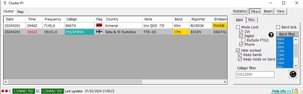

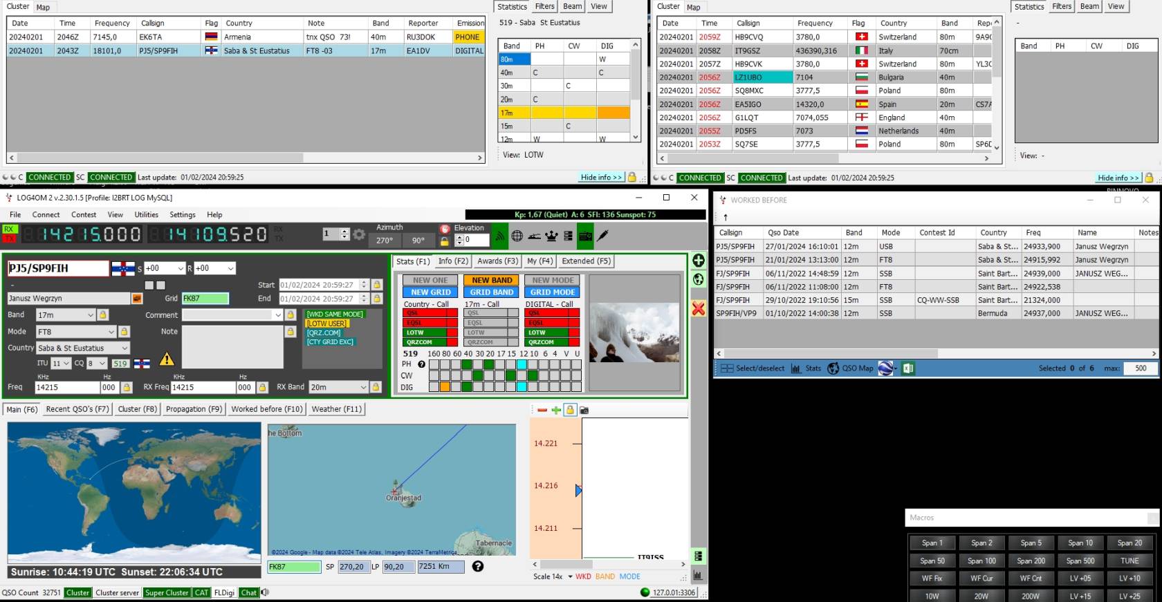

In the meantime I'll add some screenshot of my preferred setup at the moment (please consider that what I like it may not what you like) :
Here is an example where Cluster#1 form is showing me to pay attention to PJ5/Sp9FIH because I need it on 17m digital
Once clicked, I saw more details in the upper left of the main form (see the colored squares under Stats (F1) tab)
