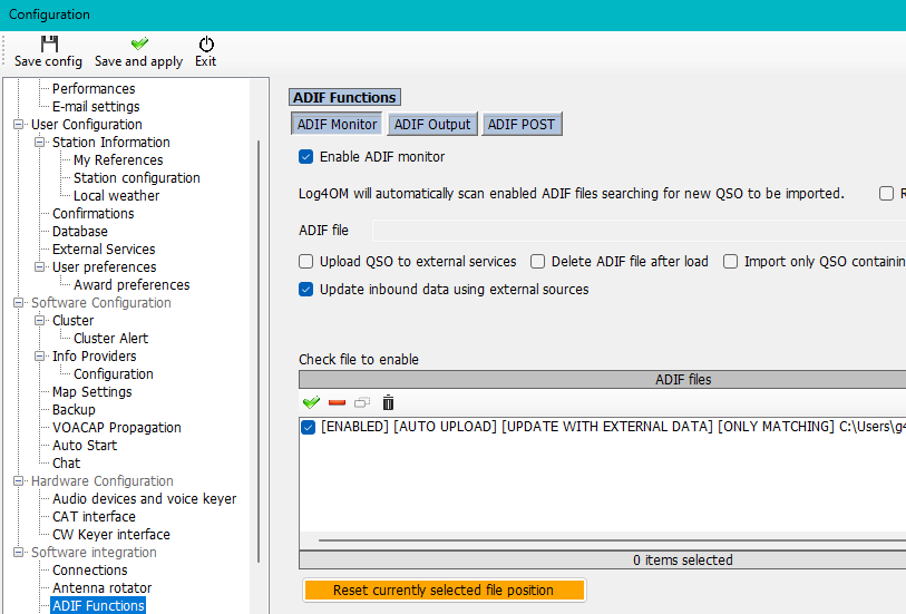

As I said earlier I have tested using the same Log4OM release that you have and it works fine, the setting is persistant after several restarts as shown below
There have not been any other reports about this from any of our 40K users
So it has to be a local issue on your maching, that can only be a bad download or install or something interfering with the save and apply routine.
