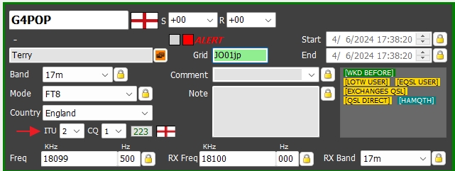

Terry,
The problem is actually the "ITU" and "CQ" boxes in the QSO entry screen. Apparently, they aren't large enough to show two digits. They only show one digit, at least on my computer, but if I click on the down arrow in each box, both digits are displayed. This is true for both manual entry of the call sign, and when the call is entered from another app (WSJT-X, for example). The same is true when using the separate "Data Entry" screen. I wish I had checked this in the first place. I haven't made any changes to the fonts on my computer - using whatever the default is. When the QSO is logged, the zones are correct. It's only in the boxes I mentioned. Can those boxes be made a little larger?
Jim N6VH

- G4POP.jpg (93.23 KiB) Viewed 4621 times

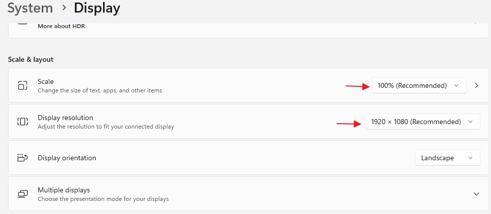

Terry,
I'm using the default settings, as shown in the attached picture.
Jim N6VH
Jim N6VH

Well I am flumuxed with this one! all I can suggest is that you ensure the latest .net framework is installs and perhaps reinstall Log4OM from a fresh download - PLease use the latest Beta release.N6VH wrote: 07 Apr 2024, 16:50 Terry,
Jim N6VH
Other than the above if it were me I would rename the Log4OM2 folder Log4OM2 OLD in the C:\Users\YOUR USER NAME\AppData\Roaming\ folder followed by a clean install. HOWEVER PLEASE NOTE: - This requires you to set up Log4OM from the start with all of your user data etc so make a backup before doing this

Jim,
I'm just trying to think 'out of the box' on this one for you. Do you have a video driver on your PC such as something from Nvidia or similar?
Might there be some setting in that video driver software that is impacting your display? Even though your O/S is indicating normal (100%)?
How about (as a test) that you reduce the percentage from 100% to say 90% and see if anything changes or not.
I wouldn't do that until you verify that a video driver (such as Nvidia) is not impacting the display.

Re: Erreurs ...
Nolan,
Sorry for the late response. I was out of town, and then had some other issues to deal with when I got back.
I downloaded and installed the latest NVIDIA driver. As far as percentage, I can't go any lower than 100%. I also tried adjusting the resolution. None of this made any difference. Also, I put a portable version of L4OM 2.0.0.0 on my computer, with the same results. It might be the age of my monitor (HP w2338h). The latest driver for it is only listed for Win 8 and earlier.
Terry,
Yes, as I indicated, I uninstalled L4OM, and then installed 2.32.01 again.
At any rate, it isn't really a major issue for me, and I can deal with it.
Jim N6VH

Re: Erreurs ...
Incidentally, I put Log4OM 2.32.1.0 on my wife's laptop, and the zones showed correctly, no problem. Therefore, it is likely something with my computer or very old monitor. My wife said buy a new monitor, so that will happen in the near future.
Jim N6VH
