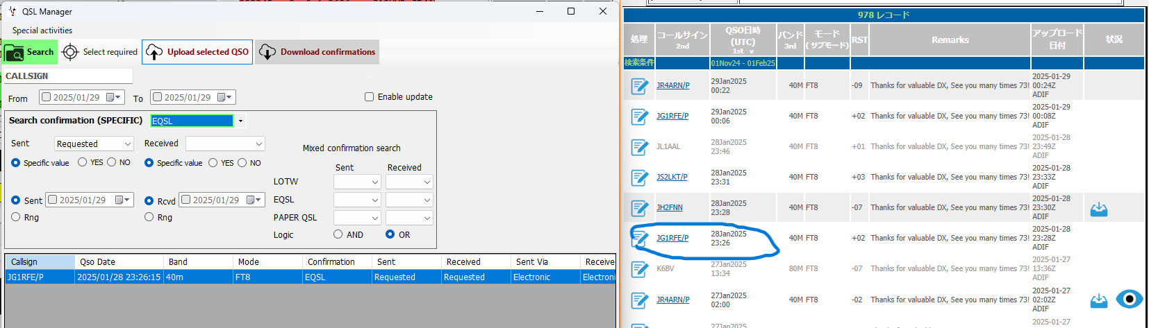

I just happened to reproduce this issue.JA9HWD wrote: 27 Jan 2025, 13:10 With my regular account, Log4OM2 automatically uploads data after a certain amount of time has passed since the QSO. This is done properly every time a QSO is added.
However, when I search for "Request" in QSL Manager at a different time or on a different day, it is listed as an upload target, but when I press the "Uplaod Selected QSO" button and execute it, there is a duplicate error from eQSL.cc. You will see a message appear. Since it is actually uploaded properly, I thought it was an error in the search process and did not worry about it.
I have not actually encountered any adverse effects. Even if I report this as a bug, I think I will be called a liar or ignored again, so I have not reported it.
In this way, even though the file has already been uploaded successfully, it is listed and when I run it, it becomes a Dup.
I think this is the root cause.
73, Kiyo JA9HWD
Re: bug in the upload process to eQSL.cc
I confirmed that this occurred again today. It seems to be occurring more frequently than I thought.
When I checked the QSL Manager, the uploaded QSOs were listed, so I set the log to trace mode and ran it.
However, when I looked at the trace, all I could see was that a Dup error occurred. It seems that this phenomenon requires tracing at the time when "Request" could not be set to "Yes".
However, I cannot continue to spit out such a large log file (6MB for processing only one station) without knowing when the phenomenon occurs, so please forgive me.
When I look at the "log.adi" for support requests, EQSL_QSL_SENT is "Y". I don't know if this was set to "Y" because of the Dup error, or if it was "Y" from the beginning when I started this.
I'll leave this series of bug reports as ``couldn't be resolved'' due to my lack of ability. This ends with me giving up.

Are they looking at the support requests I've already sent? What are they looking at?G4POP wrote: 02 Feb 2025, 17:31 Its possible the FT8 software is either uploading or marking the QSO as sent Y before its saved to Log4OM
We cant be of more help until you provide Lele with a support request!
The DB contents were attached, but the bug is that even though the status was "Y", QSL Manager recognized it as a "Request" and uploaded it.
If it was changed to "Y" in another app it shouldn't be listed for uploading in QSL Manager. And yet it was uploaded.
That's all.
73, Kiyo JA9HWD
That's all.
