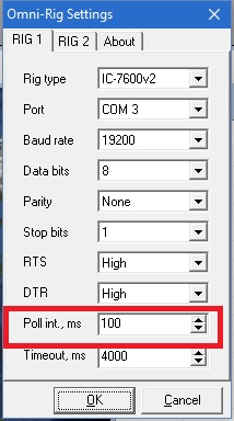

whats the polling rate, just reloaded software a little bit ago. not sure?
Posts: 11594
Re: Omnirig and KX3/K3
Its in the Omnirig settings as shown below

Anyway ... that is how my K3 is working with Omni-Rig and I also have my Poll interval set at 100ms as well.

I did see that a second double click set it up right as I changed the poll rate and no change. So will go with that since that's all that seems to be able to be done. Thanks for all the help.
