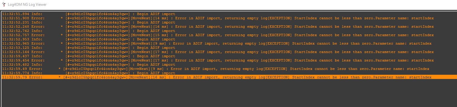

In Log4OM, if I click Help -> Realtime Log and (just for fun) enter G4POP into the DX Call field of WSJT-X this is what appears in said log :
It appears that data is coming through - just its wrong.
Oh and I have also uninstalled WSJT-X and reinstalled it (vers 2.1.2) and just for the fun of it vers 2.1.0 and both seem to be passing the same data ie I get similar messages in the realtime log.

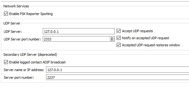

Like VK7YUM I have tried everything to get he DX call field from WSJTx making it into Log4OM V2 Callsign field. I can see with David's settings, in the user guide the secondary UDP should be port: 2333 and the UDP Server port: 2237. David's are around the other way.
Not quite sure what you mean Phil - my settings are exactly the same as in the manual ?? :?:

All good David,
My mistake, actually when WSJT-X installs the port settings are reversed. The UDP port is 2237 and the secondary UDP port is defaulted to 2333.
Phil - VK1HX

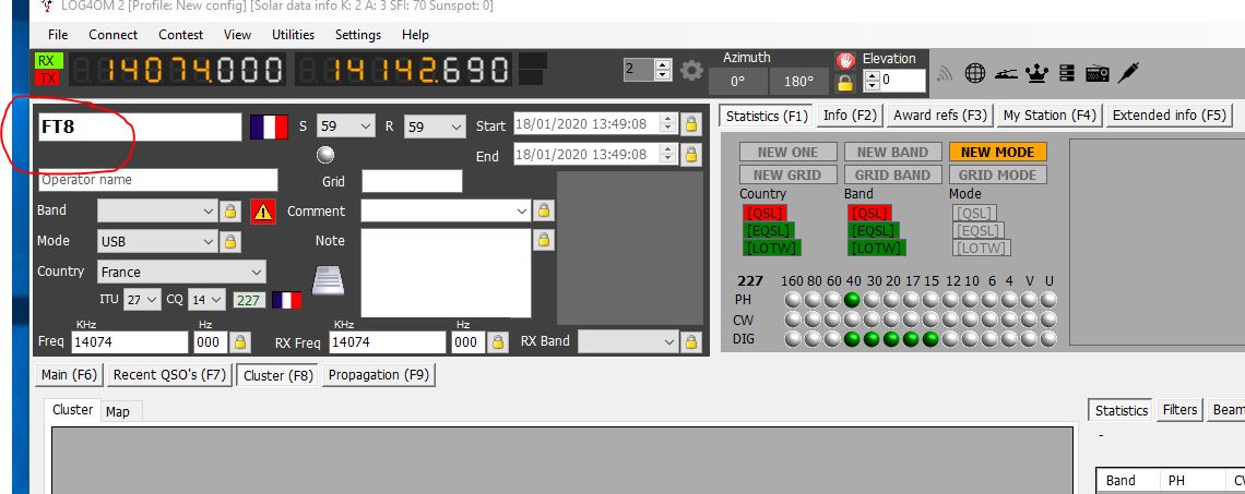

I thought we were trying to get the DX Call info from WSJT-X across to Log4OM in real time for lookup info? As shown in Terry's earlier post. Now the cluster has stopped working... works fine after a fresh install then next reboot nothing...

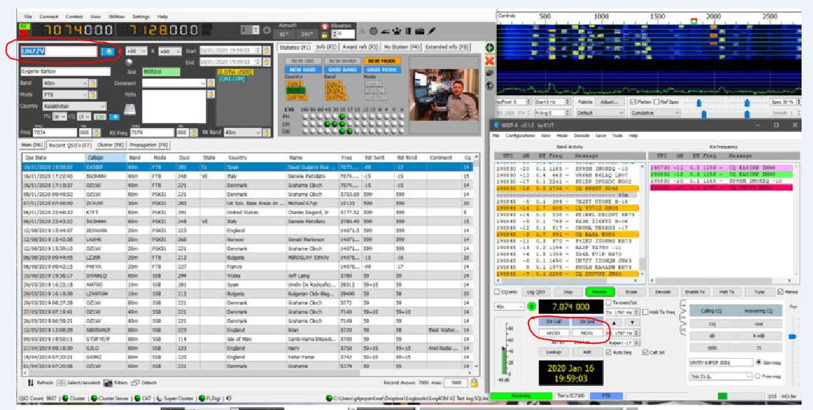

I give up. Here are my settings which are the same as everyone but for some reason I pick up the WSJT-X mode only.
