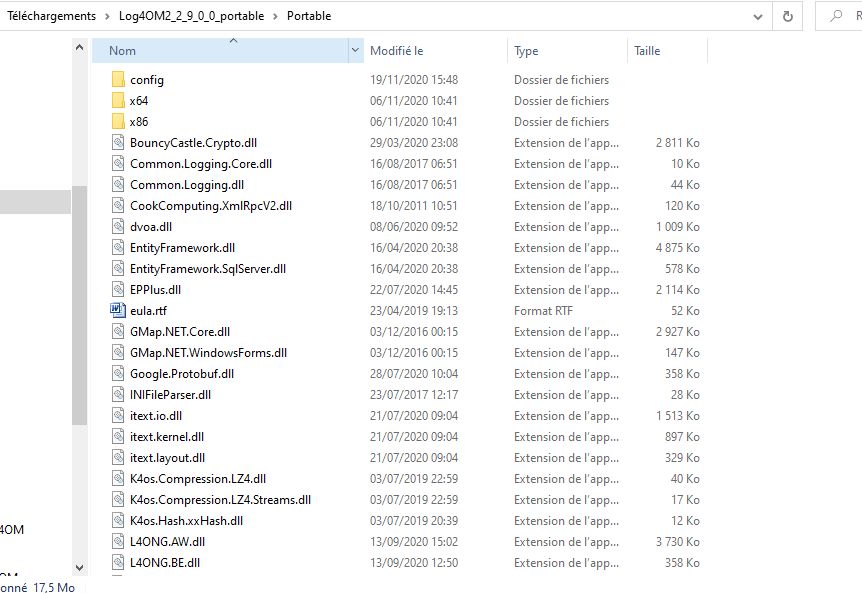

No, as shown on the title bar, this is the 2.9.0.0 folder...
Thanks + 73
Paul F6EXV

The one that worked OK, supposedly a portable instance, but it does not show portable in the title once launched.

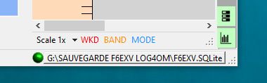

Yes I did, the backup is set to be on G:\SAUVEGARDE F6EXV LOG4OM\
with additionnal backup on the P virtual disk, which is in the cloud .
Juergen

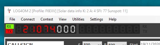

You showed me a picture where, IN THE TITLE bar of the program once launched, the word portable shows.
It never showed on mine, even on the version launched from within the Log4OM2_2_9_0_0_portable directory...
Thanks + 73
Paul F6EXV

Juergen
Here are the header and the lower right corder of the version launched from the directory indicated in my previous message.
Thanks + 73
Paul F6EXV
