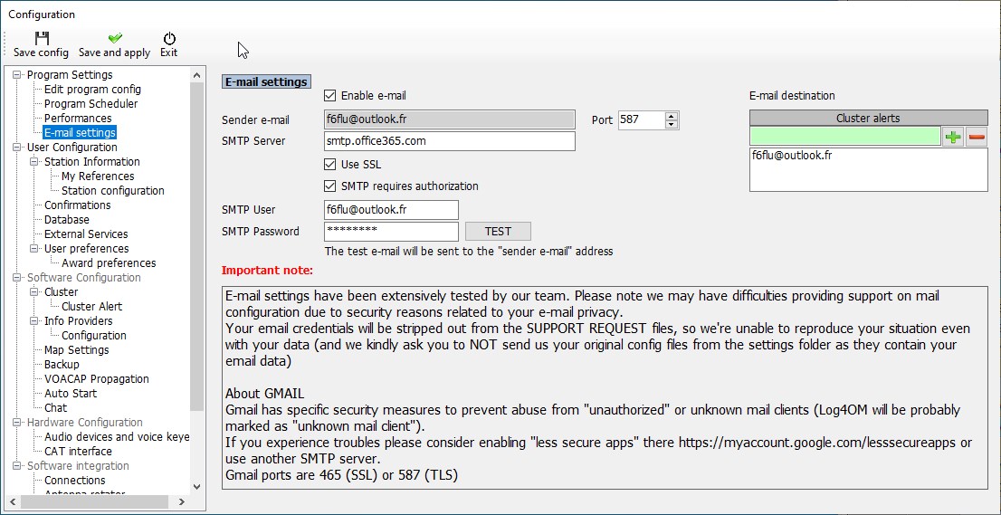

WB8ASI wrote: 13 Apr 2021, 19:48 Dan, I have the same problem. The Test email works just fine. The Alerts work fine, but does not trigger an email. I've checked my settings and everything looks good. I interested in what you find. Thanks, 73, Herb WB8ASI
Hello Herb
I think it is a problem of Log4OM
I tested different providers like numericable, orange, gmx, netcourrier, icloud
none works ...

BonJour Dan, Also, my "enable destination" box is located just like your screenshots on the "E-mail settings" page.....NOT on the "Cluster Alert" page as shown on page 78 of the User Guide (latest revision). 73, Herb WB8ASI

I just created an email account on outlook and I tested the alerts via outlook,
it still does not work, I am not receiving any email ...

[resolved] eMail alert 1
Post by F6FLU »
this issue is resolved with version #2.12.0.11
I want to thank you for all the work accomplished on the subject of alerts via email.
Many thanks to "Lele" for developing such a quick fix,
Thanks to Nolan for his perseverance and
Thanks to Terry who works a lot behind the scenes and does a wonderful job on the documentation...
