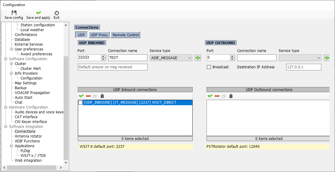

Also interesting is that the manual (the edition dated today) shows, on page 55, a somewhat unclear note (commas are your friend!)
Now if I parse that right, I think I am in the "unless" camp, where I want to use the data from the "external program" which I think includes JTDX. In any case, there is a picture of a page showing "UDP Inbound parameters" which are not explained. "Use external data" might be correct in this case. HOWEVER, that whole portion of the page is absent from the latest version (beta) of the program!PLEASE NOTE
When a QSO is in progress in an external program like WSJT etc the Log4OM lookup is only displayed it is not what is saved when the QSO is completed by the WSJT software sending the QSO via UDP
UNLESS the user elects to update the data received in the QSO sent from the external program in the Program Configuration menu shown below:

"UDP Inbound parameters" which are not explained."
Ditto, no such window in screen

Sorry dont quiet understand this comment please expand"UDP Inbound parameters" which are not explained."
