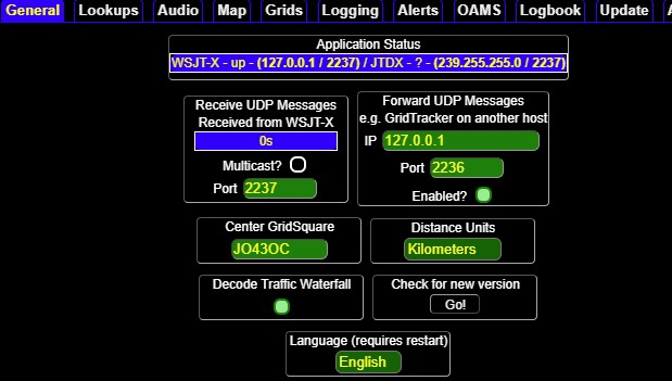

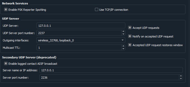

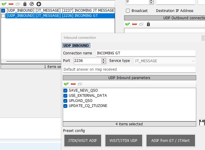

KD0ZV wrote: 21 Mar 2023, 21:08 Both actually
I found the problem why the callsign field was not filled when calling a station in WSJT-X and the GRIDs were saved with 6 digits instead of 4 as saved in WSJT-X.
I am also using GridTracker and changed the Incoming GT settings from ADIF_MESSAGE to JT_MESSAGE as it was before.
I cannot explain why it now works again but it does :P
Attached you can see my other settings, maybe there you can find the problem why ADIF_MESSAGE is not working properly for GT in my setup.
Stefan
Screenshot 2023-03-22 222806.jpg (43.91 KiB) Viewed 1779 times
