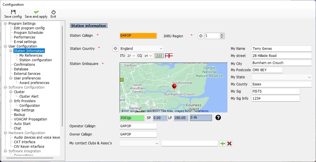

The reason that some QSO's logged from N1MM and also being imported via ADIF had the correct zone information is because if a MyITUzone is included in the ADIF file or in the UDP incoming data string we will not change it.
Incoming UDP data from WSJT will either be left unchanged if the MyITUzone field contains data or be updated from the Log4OM Program config/Station Information data tab if the zone data is missing, as shown below. Manually input QSO's will also use the MyITUzone data in the station information tab.
