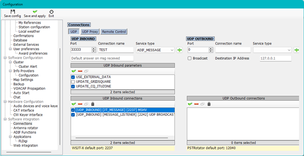

I said in my last post "As I stated earlier in the next release you will be able to decide what happens to such incoming UDP data"
If you study page 55 of the latest user giuide you will see this screen shot.
The port number and name shown in the screen shot above are fictional and just used to illustrate the process they should not be emulated
With this statement
"PLEASE NOTE
When a QSO is in progress in an external program like WSJT etc the Log4OM lookup is only displayed it is not what is saved when the QSO is completed by the WSJT software sending the QSO via UDP
UNLESS the user elects to update the data received in the QSO sent from the external program in the Program Configuration menu."
You will notice that while setting up an inbound UDP as you would for and FT4/8 external software ther are check boxes located under the 'UDP Inbound Parameters' heading where the user can define what Log4OM does to the incoming QSO data.
With this statement
"PLEASE NOTE

Okay, so your post clarifies that the picture in the instruction book, which shows those inbound parameters, is NOT YET implemented as of 2.26-03 but will be in 2.26 final. In that case the check box should allow the selection of the value provided by JTDX/WSJT-X. The existing checkbox for message 12, which goes away, doesn't do that now. I will happily test that out when the next beta with it arrives. Thanks.
