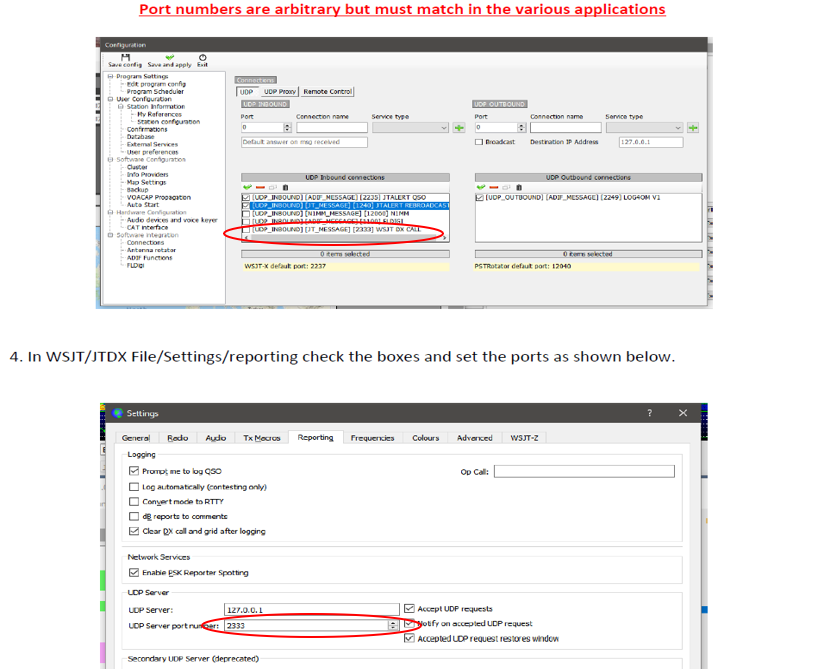

Quick question. Page 136 of the instructions show that in WSJT settings the UDP server port is set to 2333. Also on the same page, the UDP_INBOUND, JT_MESSAGE connector in L4OM2 is unchecked. Is this correct?
NN7D
Posts: 816
Joined: 19 Feb 2014, 19:44
Re: JTalert and Log4OM version 2
Post by NN7D »
OM,
That unchecked setting was for use without JTAlert running. Sorry for the confusion. During testing we have many settings which are turned on/off as needed. Eventually I suspect we will clean up those examples. So no, that entry should not be checked and is not needed - assuming you are running JTAlert.
