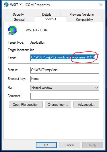

Hi Doug,
I’m not running 2 instances of wsjtx at the same time. Only one at a time. The instance that uses the rig name causes the issue. Then when I run the basic instance without rigname it’s all fine. I’ll try and do screen shots when I get home from work.

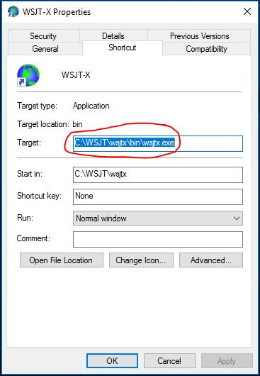

Here are the 2 different WSJTx shortcut. The one with the "rigname" extra in it causes Log4OM to received the wrong/partial information. The other one works perfectly with sending the DX Call data to Log4OM.
- Capture1.JPG (41.93 KiB) Viewed 5840 times

I´m following that procedure but it only works for 1st instance of WSJTX. Whenever I open a 2nd instance (I use a Flex) it doesn´t send the DX call to Log4Om on that second instance. I have one reporting udp port for each instance and the corresponding connection in Log4OM, but still does not work. Any idea?W7DRM wrote: 16 Jan 2020, 21:16 Hi David,
I understand the issue. The DX call field from WSJTx is not making it into Log4OM V2 Callsign field. Your settings look correct, so its something else blocking the UDP messages. I have the same settings and it is working fine here.
Are you using OmniRig? If so, you need to be running both Log4OM and WSJTx with Administrative privileges. If that does not solve the issue, try a reboot of your computer... when all else fails.
If that does not solve the issue, would you please generate a support request - follow the procedure in the manual - after trying to replicate the problem.
Doug
W7DRM
73, Santiago

That must be why mine isn't working, I have my WSJT names slice A slice B ect as the are for different slices on my flex, so how can we work around this,

In the JT Alert forum, Laurie mentioned that probably the reason second instances of WSJTX are not sending dx call info is because of the name of the second instance (-rig), apparently Log4Om is not recognizing anything but WSJTX in the name. Probably that's the same reason why with Slicemaster it does not work with either slices, because SM changes the name of WSJTX instances.
I don't know if this is true or not, but that's what I was told.

Log4OM should be accepting any software name/version info and not be picky about it.
