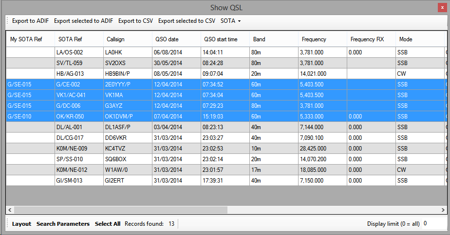

Re: How to export SOTA activator log to upload to SOTA site?
If all 70 QSO's are displaying in the SOTA stastics window and also in the export selection screen (As shown below) I cant see why you are having issues, I just checked and its working correctly when exporting a selection (Export selection as Activator) and when exporting all (Export as an Activator)
Probably something wrong with the QSO data entered?
Screenshot 2015-07-27 08.43.45.png (33.1 KiB) Viewed 7487 times

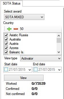

That is the problem - statistics shows 52 QSOs out of 70. I checked records and see nothing different for those records that do not show in statistics.
I found two records that are missing in statistics. One is LZ station, other is TA station. LZ and TA are not in SOTA, so maybe Lo4OM for some reason mistakenly filters out QSOs with contacts that are not originating from SOTA countries?
I guess that is the issue. I have to check all countries to get data selected but there are only countries included in SOTA listed. I guess it would help if there is option to set filter to disregard country info. For activators, country of a contact does not matter.

yt9tp wrote:so maybe Lo4OM for some reason mistakenly filters out QSOs with contacts that are not originating from SOTA countries?
As an activator any valid DXCC cuntry is acceptable, clearly Kosovo etc are not condidered
I assume that when you went to the SOTA awards screen that you selected all of the countries by clicking the small green plus sign + just under the word ~'Country' and mixed to ensure that all possible QSO's are displayed
No date range to avoid excluding QSO's by date
And either Activator or Chaser or S2S according to your requirements

Yes, I checked all countries and then i got 52 records. I also tried with countries unchecked but then I got no records selected.
I will try again. Maybe something else interfered.

I tried again. Indeed, if no countries are selected no records show in statistics.
