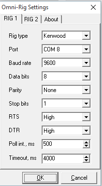

I have not seen any problems with Omnirig. These are my Omnirig settings - obviously the Com Port will vary with your setup. I'm not sure about the audio IF setting in Skimmer.
Peter
Peter

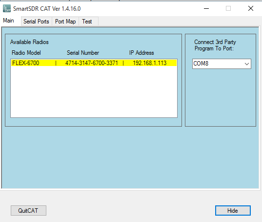

Re: Log4OM and CW Skimmer used together
Steve. The port I use for Omnirig is the one shown in the picture. I'm not using any additional ports at the moment.
Peter73 Peter G3ZSS
