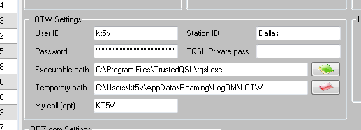

Hi Terry - External log settings seem to check out with TQSL. I should note that uploading works fine so it would seem password and location are correct. Below are some screen clips - am I missing anything?

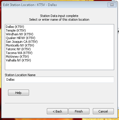

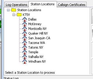

- Posts: 11594
Re: LOTW Download
In Tqsl open Dallas like you are going to edit it and check what the station location is in full

David, as SOTA activator I'm using more than 50 TQSL locations and it took me a while to find out how the LOTW download works.
In Settings > Options > External Logs > LOTW Settings I do not put anything in the "Station ID" field.
LOTW download then grabs all QSLs which match the callsign I put in the "My call (opt)" field, regardless of what my location was.
Example: After having activated around 30 different SOTA summits in DM/BW (each of them with its own TQSL location) as DL/HB9BRJ/P, I select the Log4OM profile called DL/HB9BRJ/P as active profile and a LOTW download will find all QSLs for QSOs I made as DL/HB9BRJ/P, no matter whether a QSO was made on DM/BW-123 or DM/BW-456.
Are you sure there are LOTW QSLs waiting for your Dallas location?
Try to remove the "Station ID" from your profile and try again.
GL/73, Markus

Hi Terry. I think this is the screen clip you are looking for. As you can see the station location name "Dallas" is different from the listing. There might a clue here. I will experiment tonightG4POP wrote:In Tqsl open Dallas like you are going to edit it and check what the station location is in full

Hi Markus, thanks for jumping in. Your method makes sense, so I tried it same results (or lack of results).HB9BRJ wrote:David, as SOTA activator I'm using more than 50 TQSL locations and it took me a while to find out how the LOTW download works.
GL/73, Markus
As mentioned after trying several times to download through Log4OM, I pulled a lotwreport.adi directly from LOTW with about 600 QSLs so they were there waiting. I also tried setting the date on the Log4OM download dialog well back in the past - nothing.
Going back to Terry's question, I tried some variation on station ID with no success. Note that an upload through Log4OM worked flawlessly with KT5V as station ID.
I'm at a loss. But feel as though I'm missing something obvious.
