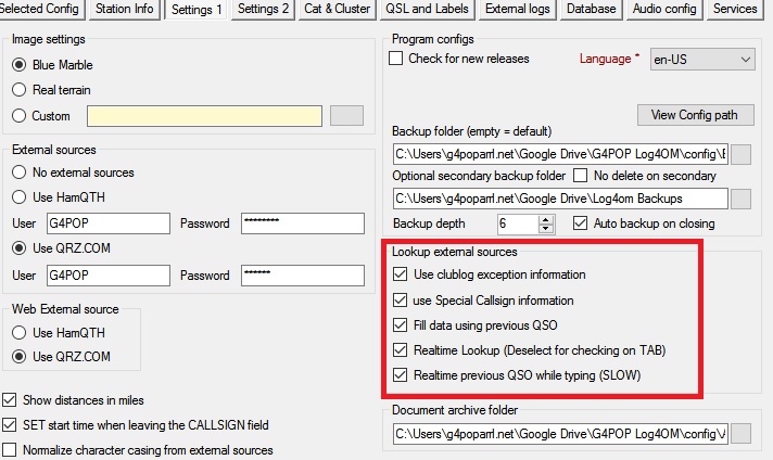

I suppose you have got the settings set correctly as below

Thanks. Yes, I already have E51MKW in my log, but I figured that might be affecting things, so I changed the country to N. Cook Is. in the log, a new entry still resolves to S. Cook. I went into settings and unchecked "Fill data with previous QSO", still resolves to S. Cook. And yes, I have the others checked, except the last one.

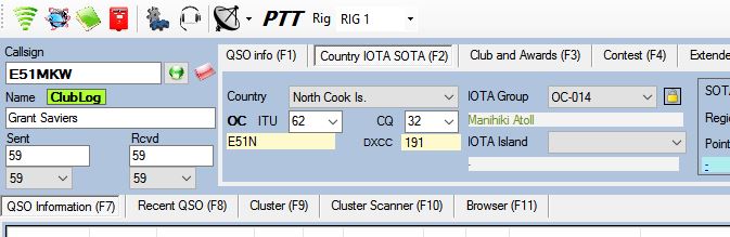

You will note from the screenshot that it is obtaining the data from the Clublog file
If a call is not identified in the normal country file we then search both the SCL and the Clublog file, if it's still not found we check QRZ/HamQTH
