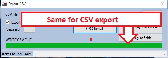

Hi - This happens when exporting .csv files, too. Can you do a screenshot of where the completed message appears? I can't find it.
Thanks.
Posts: 11617
Re: Stuck ADIF Export in Process... Message
Try minimising the main window, you should see this
Where are you exporting file? Did you have write permission on the folder? Log4OM took about 0.4sec to export 1000 qso..
